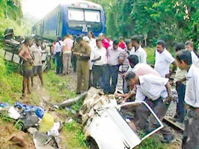

Dear All,
There are unbelievable railway an accident is happening in our country, final the accident was recorded last week. 8 school children were died and 11 children ware injured when their van collided with a train at a level crossing.The research was en counted that main reason for accident is unprotected railway crossings
As a solution The Government announced to the public to collect ideas find low cost solutions for above matter
So I would like to request to this forum partners give your valuable ideas on micro controller base solutions to address above problem
Your contribution on this regard is highly appreciated.
Thanks in advance

Last week I was driving motor bike with my 8 yeas old son to school. before 500m to railway crossing one school van passed us and when we come to the railway crossing 8 of them died in front of me.
