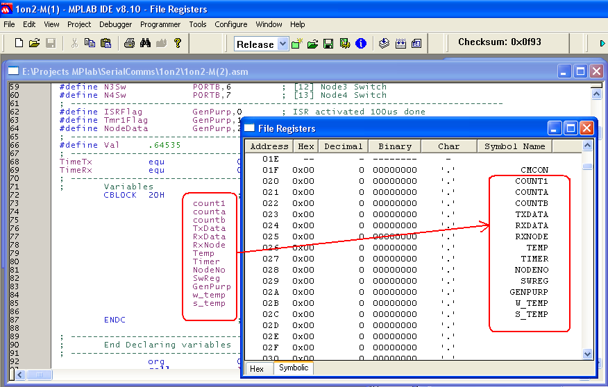

Is it just me or has Microchip’s MPLAB IDE software changed a bit from version 8.46 onwards (perhaps this might even be on earlier versions, but I know 8.10 does not do this)
With reference to the attached picture, note that variables declared under CBLOCK actually shows the symbol name in the file register (ver 8.10). In version 8.46, and all the later versions that I’ve installed, the symbol names for declared variables simply does not show in the file register.
Is there some checkbox that needs to be ticked to have this displayed? It’s quite annoying to just look at an address (e.g. 027) and then having to figure out to which variable name it belongs.

Just place the mouse on the grey toolbar next to the Symbolic Name and Right Click - all your display options are there.
Symbol Name field is selected. I see the symbol names for the usual PIC related registers TXREG, RCREG, CMCON, but from address 020 to 080 there is simply NO SYMBOL name.
