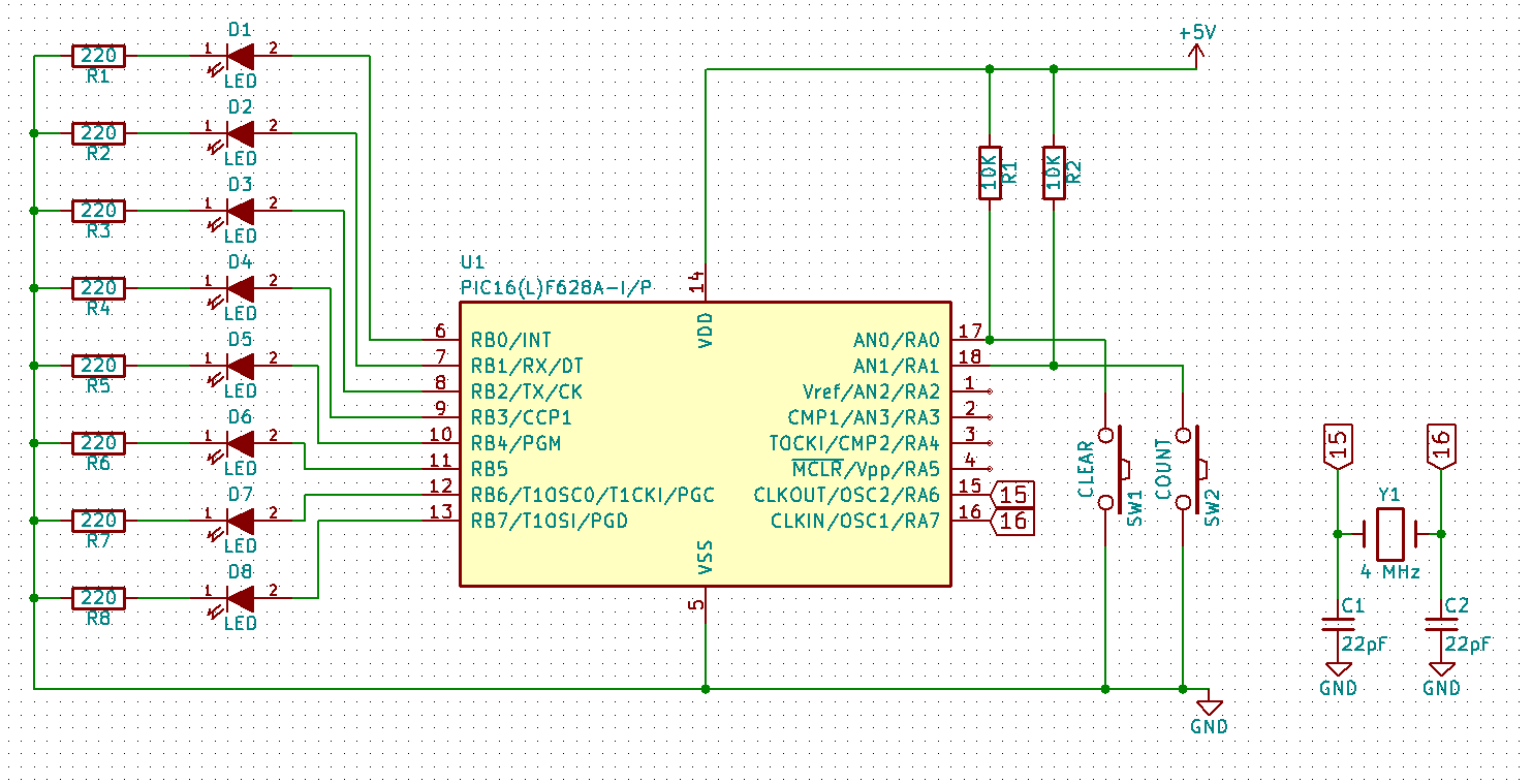

I'm still learning to crawl in PIC microcontrollers. Working with a PIC 16F628A

The issue is these restricted memory errors in the watch windows. How do I solve this?
Using MPLAB IDE 8.92 with MPLAB SIM
Why can I not watch RA0 and RB0 ? Suggestions anyone.
The watch window is for registers The three symbols you have used have no address signed to them
All you have is PORTA = address 5 and the binary view.. You can't put bit values in...
RB2 = 0x0C ... Obviously wrong.. never use the watch... I just use the SFR viewer..
RA0 is bit zero of port A, so you are looking at address zero which is INDF which is a restricted area.
I just cannot get this program to work. It produces no error messages on compile. But logically it does not produce the correct result.
You need to watch out for things like .... "INCF portb" .... without specifying the file register it defaults to the W register ...
INCF portb, F ... is probably what you want, but again there still could be an issue. Sometimes you can't write directly to a port like that.

Well.. If you want to use RA0 and RA1 as digital inputs you'll have to turn it off..
No, not forgotten. That is a sample straight out of a textbook. Hence I do not have enough background information yet to solve the issue and the plea for mentoring. I searched for errata on the publishers website and came up empty.
CMCON has not even been mentioned in the textbook as of yet.
Is your book specific to the 16F628? (highly unlikely), CMCON is pretty well specific to that device and MUST be turned OFF to use the port as normal.
If you check my tutorials (which use the 628) you'll see all programmes do exactly that -
Heard the 16F628A was identical to the 16F84A. The tutorial is based on a 16F84A and I was converting it to 628A. I have stacks of books based on the 16F84A and never had the time to get to them. Shame to throw them out.
That's why my tutorials say:
org    0x0000            ;org sets the origin, 0x0000 for the 16F628,
                   ;this is where the program starts running
   movlw    0x07
   movwf    CMCON            ;turn comparators off (make it like a 16F84)
Notice it's the VERY first thing the program does.
