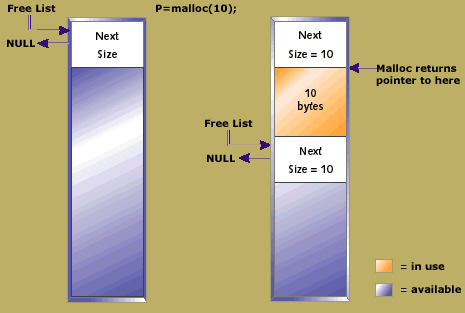

I'll simplify this as much as I can and do my best explaining it.
You have 1000 bytes of heap memory. The bytes are numbered from 1 to 1000 (byte addresses).
You need 2 variables:
heap_bottom = 1 // This marks the start of unused heap memory.. when this reaches 1000 then all the memory is used. Possible free memory is in the freelist.
freelist_pointer = NULL // this is a pointer to first free memoryblock.. initially NULL
When you want to allocate 10 bytes of memory you record that size in the byte just before the actual memory pointer that is returned. So after calling malloc(10) the variables contain:
heap_bottom == 12
freelist_pointer == NULL
Malloc returned pointer to memory location 2 and location 1 contains the value 10.

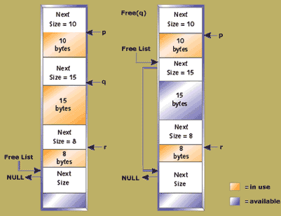

Now.. lets free memory, call to free(2) should free the memory at that position. All we need to do is to write that pointer value to the freelist.
freelist_pointer == 2
We also write NULL to the memory location 2, because this memory block is the last node of our list.
Free(34):
Now, we need to link this memory bloc to the freelist. This is simple linked list addition.
Write 34 to the last nodes pointer and set this node as last node.
memory location 2 == 34
memory location 34 == NULL
Now, our variable "freelist_pointer" pointer points to memory location 2, which in turn points to memory location 34, which points to NULL.
When you need to know the size of the free memory block, you just read the byte before the memory block i.e. locations 1 and 33 in this case.
Well.. that is quite a mess. One good picture would explain it much better. These pictures are not exactly related to my text. But very close.
The important thing to know is that every allocated memory block has a header that contains all kinds of information you need. The size of the memory block, pointers to next free memory block etc.

Say that you now free (13).
You'll get a contiguous part of the memory which is free - from address 1 to 43 (inclusive).
How do you efficiently make them one contiguous free block of size 43, instead of 3 contiguous blocks of sizes 10, 20, 10?
Yes, you will get contiguous free blocks and it is a good idea to combine them into single larger block. I don't know what would be the most efficient, but keeping the freelist in order (by address) is a good start. Then you only need to check the previous and next block in the list. If their space collides with the new node, then combine the blocks.
