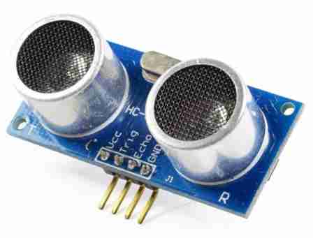

This time I leave a function to measure distance with the HC-SR04 ultrasonic sensor.
The code is commented line by line.
Sensor:
Datasheet:

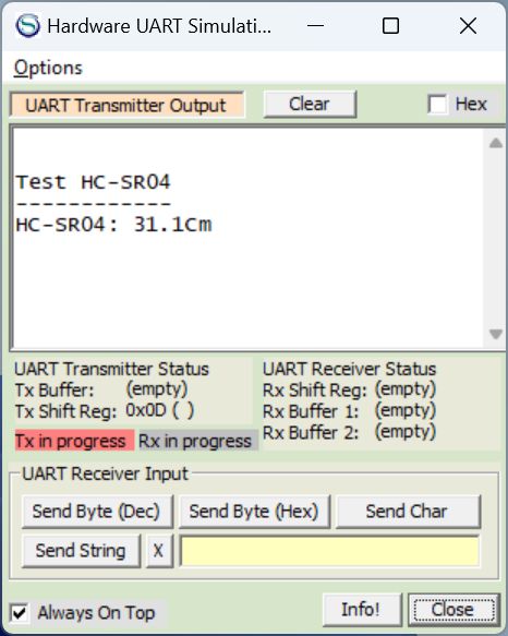

Hseropen 4800  'Initializes the RS232 serial port.

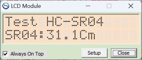

Lcdinit  'Inicializa el LCD sin cursor
Lcdout "Test HC-SR04"  'Print the text on the LCD
Hserout CrLf, CrLf, "Test HC-SR04", CrLf  'Send the text to the RS232 port
Hserout "------------", CrLf  'Send the text to the RS232 port

        Lcdcmdout LcdLine2Home  'Cursor to the beginning of line 2
        Lcdout "SR04:", #Distance, "Cm  "  'Display the distance on the LCD
        'Lcdout "SR04:", #Distance, "In.  "  'Display the distance on the LCD
        Hserout "HC-SR04: ", #Distance, "Cm  ", Cr  'Data output through the RR232
        'Hserout "HC-SR04: ", #Distance, "In.  ", Cr  'Data output through the RS232
