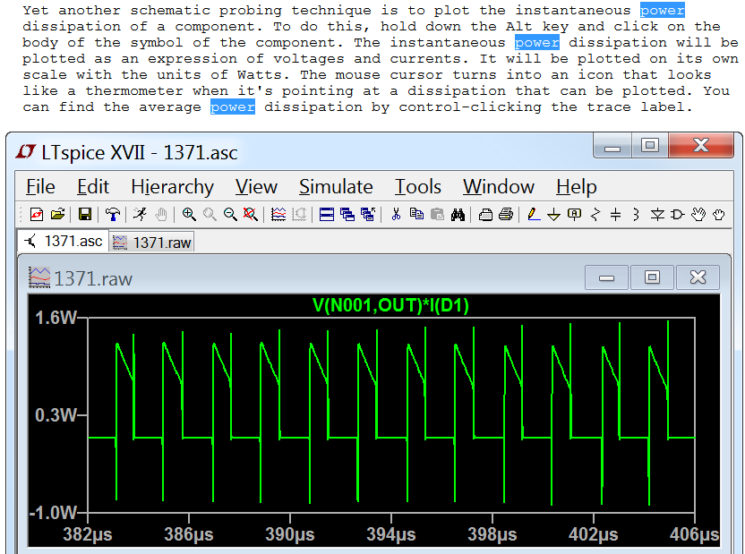

I know that it is possible to measure the power dissipation in LTspice according to this source:
"To measure the wattage dissipation of a component , place the cursor on the components and press and hold down the ALT key, a thermometer cursor should appear. Read the Watts on the bottom screen screen status text"
But do you think it is okay just to take average value of the losses? Cause it is really a large variation I think, like the figure shows the losses over the capaictor?
And about the temperature? It is not possible to measure the temperature right?
I think I read somewhere that ronsimpson said it can't be done. Are there any other way maybe?

You know how to get
instantaneous watts. :) Now average, which might be hard in that LTSPICE will not hand you a number
Yes, instantaneous watts. So it would be alright to use the average, if I look for the same time period every time for each component of 10 ms? In this case, I have 0.074 W?
Make sure your circuit can withstand all the instantaneous values. As an analogy, folks have drowned in rivers that averaged 1 inch, but were 10 feet deep in a couple of spots.

I have 0.074 W?
Why are you doing
this? heat or energy??
If you want to know how hot a part is going to get ....... that is one question. If you are looking at energy in/our that is another problem. (which)
How do you get negative watts? (averaging + and - will result in 0 watts)
If you want to know how hot a inductor is going to get you need to know current and DC resistance. (V*I does not cause heat in a coil)

If you look at transistors, diodes, or resistors the LT SPICE "temperature" function works. It does not measure temperature but watts. W=V*I
LTSPICE does not measure watts loss with inductors or capacitors.

Yes, but how do I measure temperature in LTspice?
You can not.
To measure temperature you need "thermal resistance" for each part.
AND
You will need to make better models for coils and capacitors.
What part do you want to find the temperature of?
