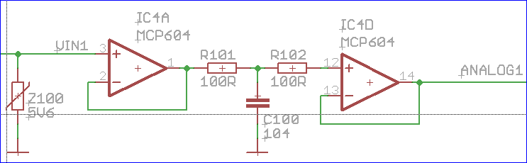

I am using a Microchip MCP602 to buffer and filter, with unity gain, for a 0-5Vdc clean DC input.
According to the spec sheet the out should swing Vss+100mV and Vdd-100mV but for a +5Vdc input I get only 4.25Vdc output. Range 0-4.25Vdc works 100%, above that is flat at 4.25Vdc.

Hi Eric
The output will go straight through to the A2D input of a PIC18F2523 but for now I am testing it either open circuit or into a 25K load as the spec sheet suggests to test for Vdd and Vss +/-100mV. Enclosed is image of SCH.

With 5V applied to the input, what does the first amplifier pull to?

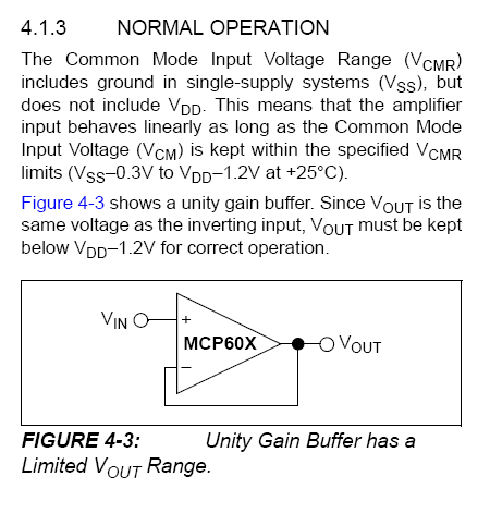

You did measure Vcc, didn't you?
Are you saying that MCP604 is not a modern, rail-to-rail output opamp?
Yep, although I should have said "So go and buy a modern, rail-to-rail input and output opamp"
Directly from the datasheet:

Well found everyone, mystery solved. many thanks. It was actually very stupid of me not to see that in the DS :(
I will use MCP6041-42-44 in the future :)
