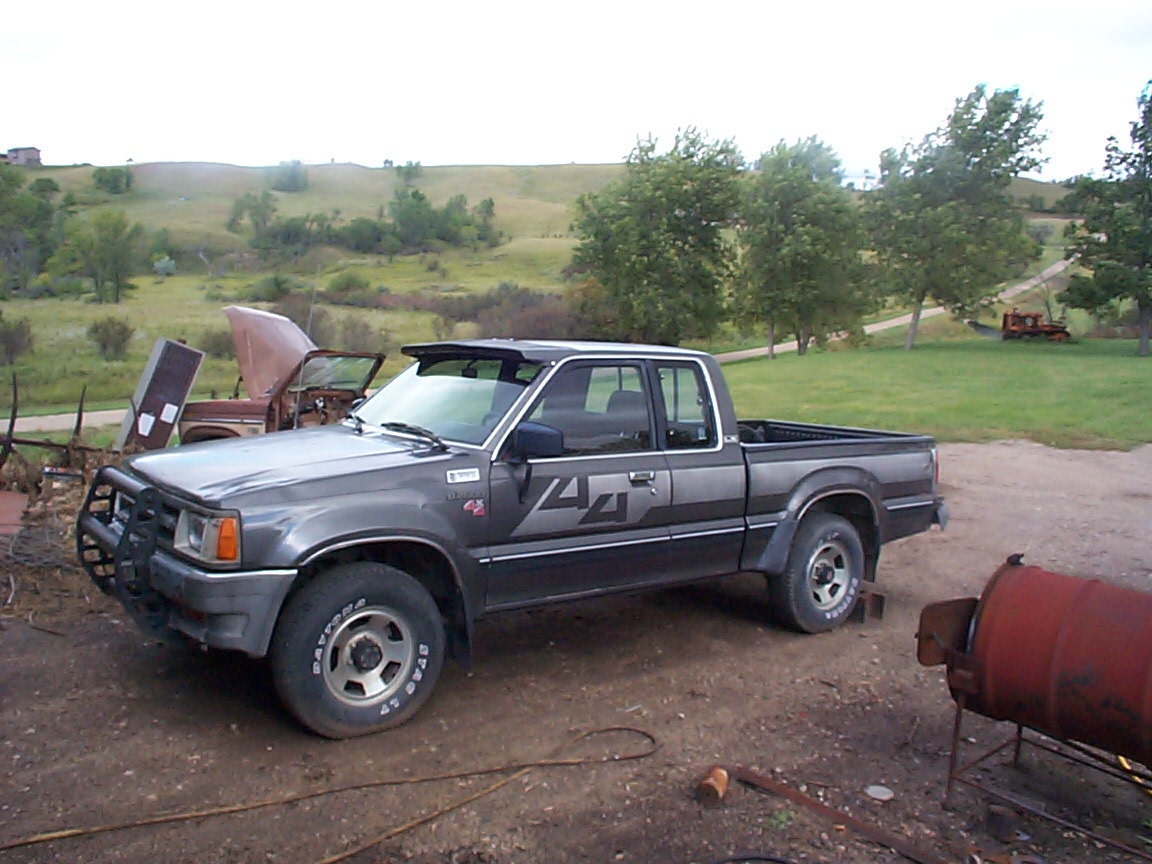

What I started out with was a somewhat mechanically neglected 1987 Mazda B2600 extended cab 4x4 pickup. Originally it used an overly complicated and unreliable emissions compliant electronic carburetor system that was typical in the mid 1980’s. That particular design Mazda used was impossible to tune properly or keep in tune and was an overall more of a waist of fuel and engine power than a gain to anything. What I did for the full propane conversion was to remove the entire emissions system from the truck and replace it with a simple single barrel vapor carburetor throttle body that came from an old propane powered combine engine I found at the scrap yard. All the old combine throttle body needed to work was some minor bolt pattern rework to make it physically compatible with a modern Woodward vapor mixer that attached to the top of it. It’s the same setup as the vapor carburetor systems used on propane powered forklifts.
To start out I removed everything that was emissions related in the vehicle, the smog pump, evaporative emissions control unit, the multiple vacuum control units and lines, the crappy electronic carburetor, the catalectic converter, and the rest of the rotted out and undersized exhaust system. All of this was reduced down to a simple all mechanical propane carburetor and vaporizer unit and the now unrestricted 2 inch exhaust system.

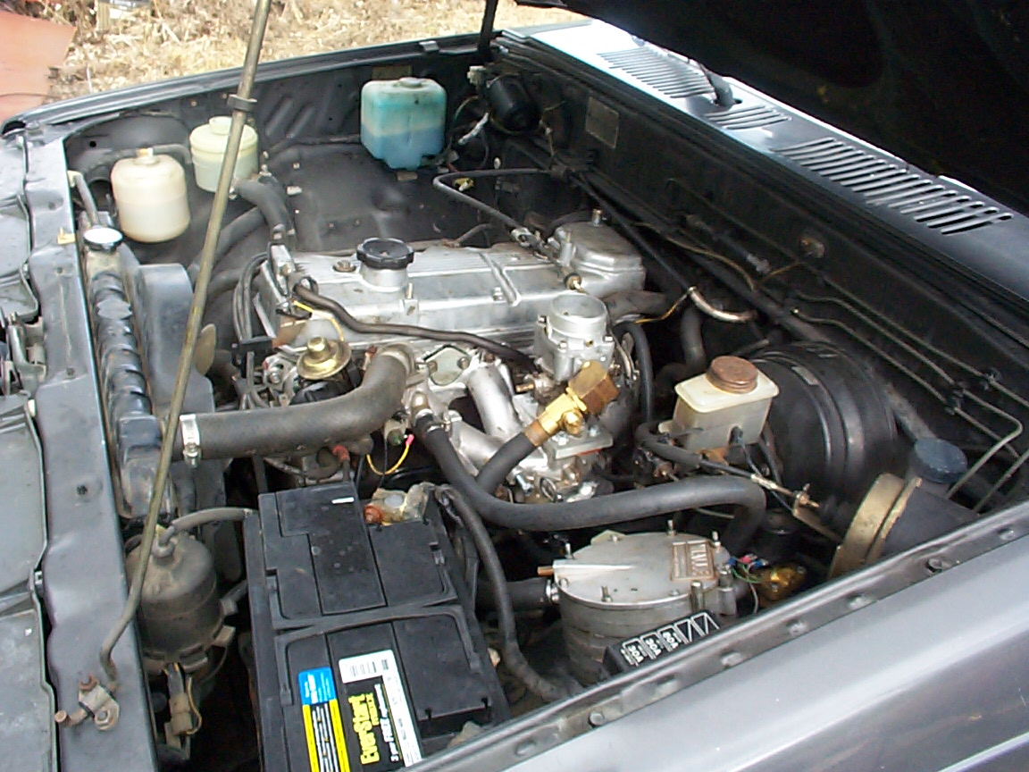

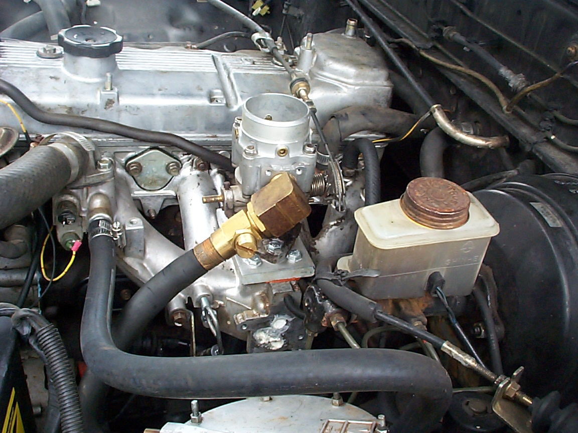

The old single barrel combine throttle body did take some minor modifying and intake manifold rework to get it to fit but it was not hard. I made an adapter plate out of 3” x 4.5” x .5” aluminum stock. I drilled and tapped it to fit the old four bolt pattern the tiny two barrel electronic carburetor used then drilled a larger hole through the center that was just slightly larger than the throttle body throat. The throttle body I used only has two bolts holding it down so I drilled and tapped two holes in the adapter plate so it had a solid point to attach to.
After that it was just a matter of using a die grinder with an aluminum cutter to reshape and blend the transition from the single barrel throttle body down into the intake where the original two barrel carburetor once sat. This big single barrel vapor carburetor gives it about 50% more intake air flow capacity over the undersized two barrel which works well for getting more power due to simply having far less intake restriction.
The intake manifold does need several slight modifications for this engine which involves plugging several ports that are no longer needed or beneficial to a propane fuel system. The first is plugging EGR passages either by welding it shut or using JB weld epoxy. The same goes for several coolant circulation passages that where intended to heat the intake manifold and the old electronic carburetor.
What I did was clean up the ports and passages and block them off with healthy slugs of JB weld epoxy. There are two coolant feed ports and two coolant return ports that need to be blocked off. Also the EGR valve assembly needs to be removed and its related ports and passages need to be plugged as well. One of the EGR passages goes up through the intake manifold and connects to a passage in the head that goes directly to an exhaust port and the other passage goes into the intake just below the carburetor inlet.

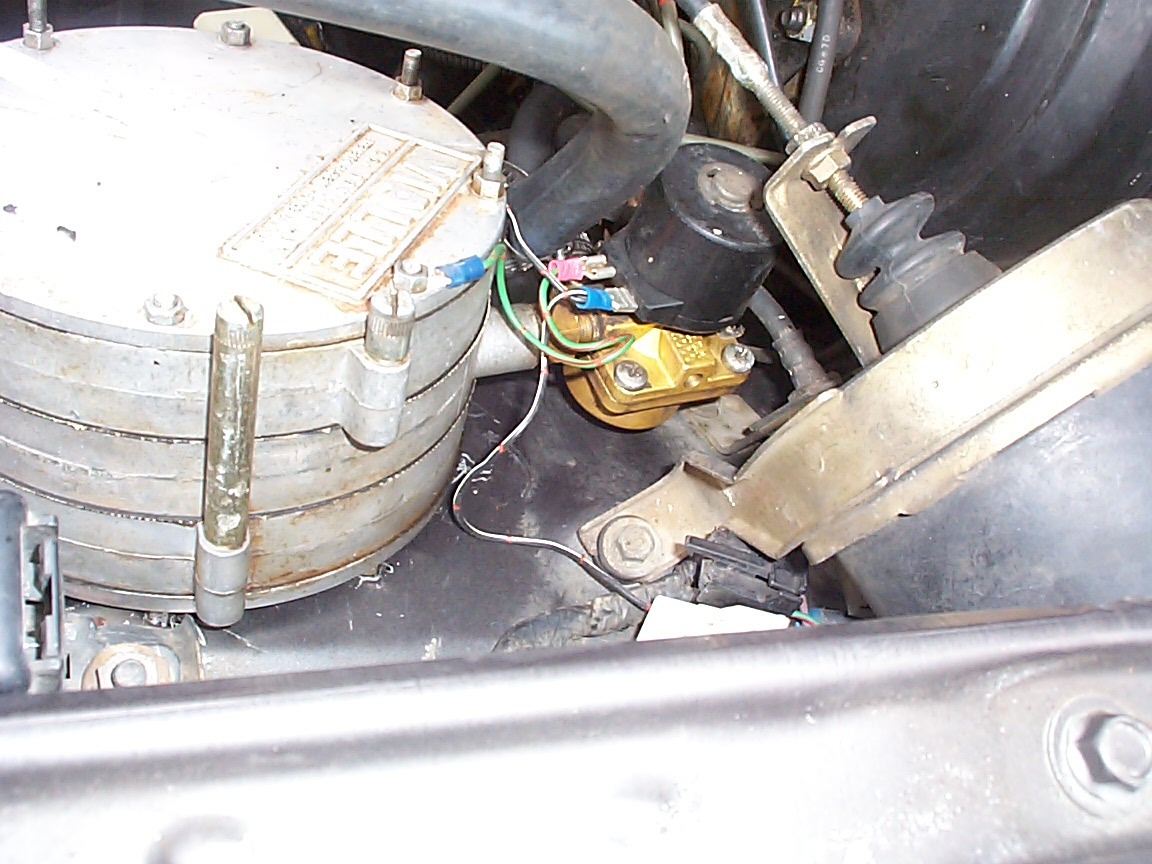

Electrically this propane conversion did not require changing anything other than the removal of all of the emissions and vacuum control wiring. After the 20+ control wires are removed I was left with two wires, one for the oil and temperature sensor and one for the temperature gage sensor. The only other remaining wires going to the engine are the ones for the alternator and ignition which are in their own harnesses so they do not need to be changed.
The vaporizer unit for the propane system only needs one 12 volt power lead from the ignition for it to work. Being the 1987 Mazda B2600’s have an electric fuel pump control system I just re routed its output line from the pump to the vaporizer fuel solenoid which was an easy one wire cut and splice job. The vaporizer does need to be part of the coolant circulation so I plumbed it into one port near the engines thermostat (a now unused emissions sensor port also where one of the intake coolant passages fed from) and returned it to the return line where the intake coolant return originally went. By doing this it keeps the engines coolant circulating as it needs to while also keeping the vaporizer heated at the same time.

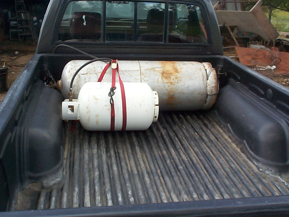

With all of that done then it’s just a matter of finding a good propane fuel tank that will fit on the truck. For me being the old fuel tank is no longer needed and the simplifying of the exhaust system left me with loads of underside room I am going to get a set of tanks that can fit underneath the truck and plumb their filler ports into the original gas cap location.

Power and performance wise the truck is very snappy now and the fuel mileage seems to be stable at around the mid to upper twenties! By figuring the fuel mileage as a cost per mile ratio comparison of propane Vs gasoline that works out to a cost per mile equivalent equal to having a pickup that would get around 45 - 55 MPG on gasoline!

As you can see I am using some old propane tanks for the test and tune until I get the tanks that will fit underneath.
Officially this truck is now TCMTEK2 and my new license plates should be here in a week or two. :D
