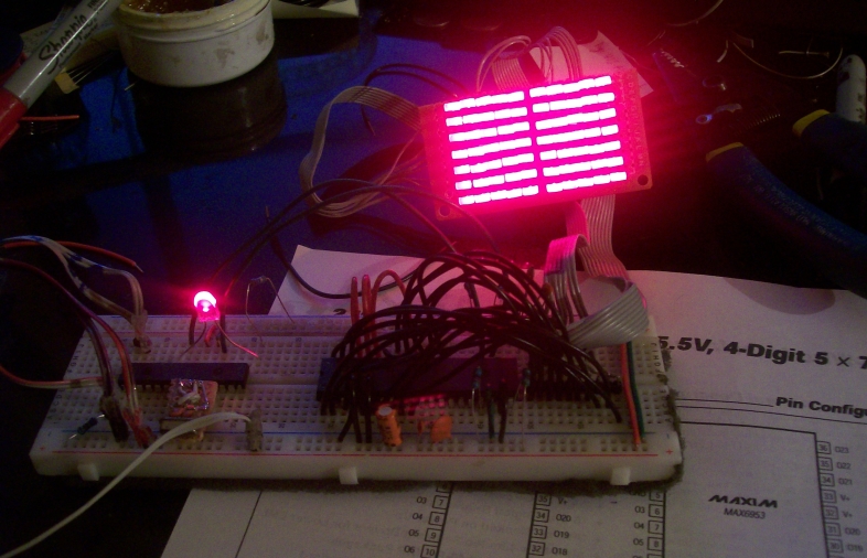

Hey just wanted to share this recent project. Its really cool. I used a MAX6953 to controll a 2 digit custom 5x7 matrix. I even made it look like its scrolling :D what cha think?
matrix-jpg.23270
[embed]http://www.youtube.com/v/Fhgz1Y5KZsU[/embed]

Thats cool, only thing I would add is smoother scrolling, eg 1 colum at a time instead of 1 character, unless of course your gonna add more characters. but for a 2 char display smooth scrolling would be much more readasble.
is the max6953 the charlieplexed chip?
SMUGangsta : Im not sure i can smooth scroll like that. Since the MAX6953 from what i know doesnt have that command in it. It does have 24 RAM spots for custom characters .. with some special coding i can create 5 custom characters for every character i send out put it in the buffer and load then 1 by 1 so it looks like its scrolling but thats hard work :D Ill try it and make a sample.

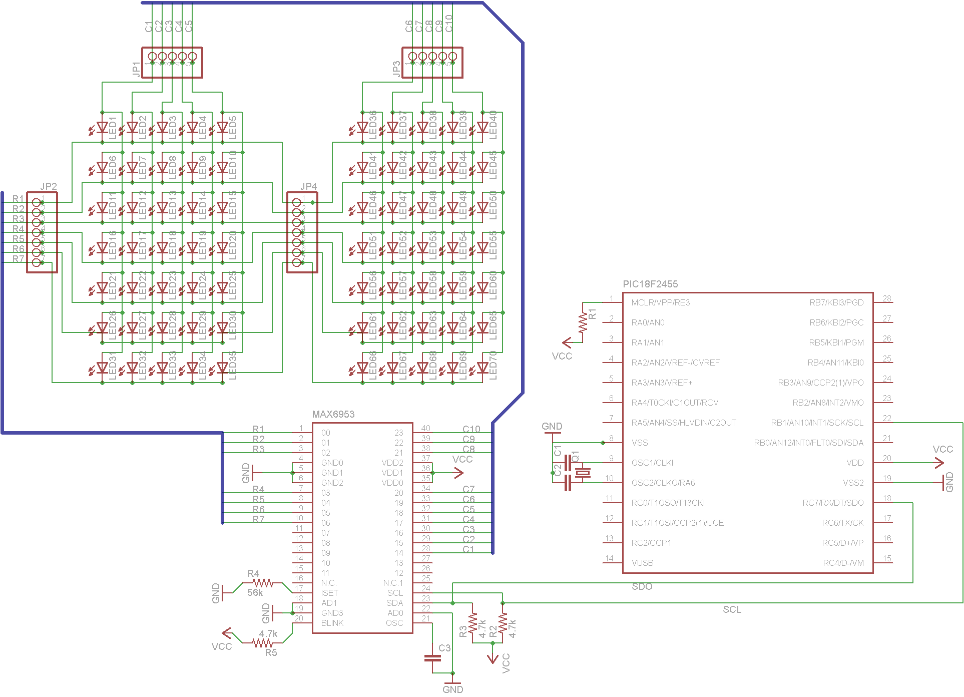

Schematic:

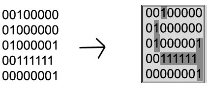

SMUGangsta:
I just realized it would be impossible to smooth scroll without making my own character on the pic. Since the way the MAX6953 stores data is um... sideways...
For instance... The letter "J" would be:
j-jpg.23274
Just had a lookie at the datasheet,, its niot the chip I was thinking of. Looks like a nice chip none the less - will have to get me one of these!
I see what you mean about the smooth scrolling, it would be possible, but would probably require loads of space in your uP as you would probably have to keep a local copy of the entire character set and build each custom character from it directly before displaying it - which is probably a lot of work - i guess it depends on the application.

Nigel you are correct. You can store a character set on the PIC and display it but the only issue is to display a character from a table/array you have to load the character into one of the RAM fields on the MAX chip. Hence a scroll would look like this:
1. Get character from table/array
2. decide which way to scroll and shift character data 1 time over
3. Send character to max ram00
4. shift over again
5. send the newly shifted data to ram01
6. shift over again
7. send to ram02
8. shift over again
9. send to ram03
10. shift over again
11. send to ram04
12. display character (normal)
13. display ram00
14. display ram01
15. display ram02
16. display ram03
17. display ram04
18. Repeat step 1 if it is a string.
You see the issue now?

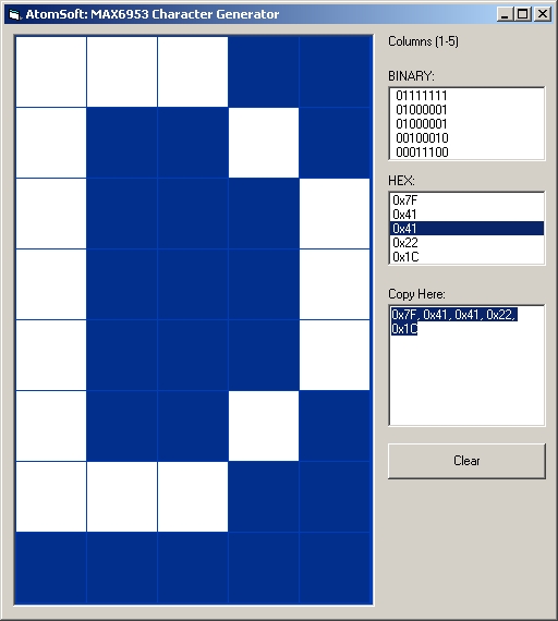

Also as for the character set. You would have to make a complete set. I am sure i can make a program in VB to create my own characters like i did for the LCD module. I cant use the one for the LCD because for the MAX6953 the characters are loaded sideways(like rotated 90 degrees).
Its not to hard to do but not sure how it would look. Ill try it with about 5 letters. "Hello" to see if its worth creating a whole character set.
Here is a small app i made:
maxgen-jpg.23285
Here is the program.
  • MaxGen.zip
