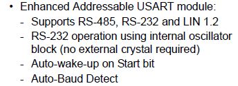

electroRF said:
...I'd like to communicate between PC and PIC18f4520, and need MAXIM-232 for the voltage levels convertion.
The PIC18f4520 already supports RS-232.
As would most PCs. If not, a simple USB to RS-232 converter would suffice (in most cases).
Or am I missing something?

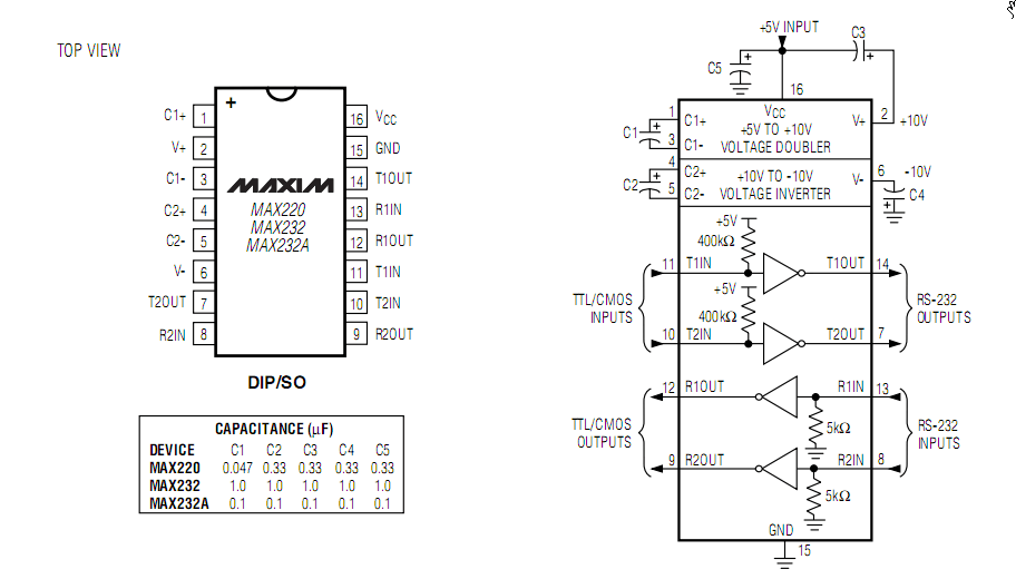

Hi bob,
My concern is that the PIC outputs 0V and 5V RS232 signals, while the PC outputs -12V and +12V RS232 signals.
Therefore, I'm afraid I cannot connect the pic directly to a PC.
You see the problem?

hi RF,
The MAX220 is a low power version of the MAX232 and is OK to use as a PIC to PC RS232 level shifter, use the correct capacitor values for the MAX220.
E.

hi Mr Gibbs
OK.
Yes, it can be used for a translation such as you are considering.
