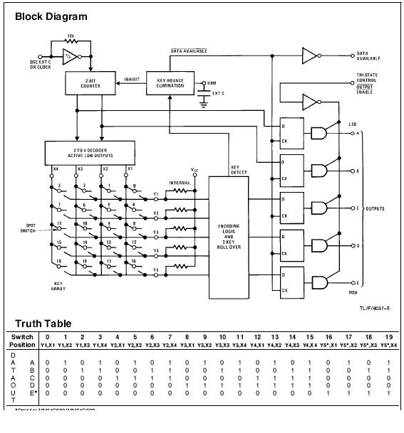

..According to above Tittle, I am building an 4X4 keypad with use of IC MM74C922 base on Motorola 68HC11 microcontroller. from the cct diagram below, Post01.JPG,

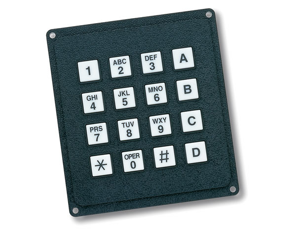

and after i have read throught about the truth table, and i wish to merch it with my keypad but i found that my matrix keypad which i brought it about 6 bugs as bottom
and i hv discoverd that the key array of the keypad i purchas that different design with the datasheet:
X1,Y1 =1 X1,Y2 = 4 X1, Y3 =7 X1,Y4 =*
X2, Y1 =2 X2,Y2 = 5 X2,Y3 =8 X2,Y4 = 0
X3,Y1 =3 X3,Y2 = 6 X3,Y3 = 9 X3,Y4 = #
X4, Y1= A X4,Y2 = B X4,Y3 = C X4,Y4 = D
So, as above problem, should I defind the output bit for the each switch first by program after scan it ??
Or I should do in other way?? Please everyone any Idea ???

You can do it according to the schematic according to the datasheet right? The picture in your post is only the block diagram of it. You can get some example connection under 'Typical application' in the datasheet.
okok I got it..thanks....i m now think about the program...I will.post any problem if i discover it..Thanks Bananasiong
hi chingbor,
You have got the X's in the wrong order and the Y's in the wrong order.
If you are looking at the connector of the back of the pad they don't run in sequence.
If you cant work it out let me know.
hi chingbor,
I have just compared your pads layout, with 3 other pads of a similar style, your pad is printed as a telephone style layout, which I cannot match with the X/Y matrix.
I would suggest the program reads the 74C922 output and uses the code as an offset to Table address in the program that has the 'character' to suit the pads key printing. [RETLW]

HI ericgibbs;
Thanks for your reply..ok...may i ask that, is it possible if i create 1 library in my ROM with address $B600?? which is
eg. Y1,X1 =1 in my key pad,
so i store this equilvalent in my library... and then if the MCU detect this X1,Y1, according to the the truth table is [A=0, B=0, C=0, D=0].
But i will Identify [A=, B=0, C=0, D=0] is 1??
and how is the concept ???? Please
The 'data avail' signal indicates a key is pressed, if you get a DA signal and read all 0's, then its the '0' key.
Normally if the pad had a matrix that gave a '0' code when the key named '0' was pressed,
I would 'OR' the key value with 0x30 giving an Ascii '0'. and so on for keys 1 thru '9'.
But, as your key top names dont seem to relate to the keycodes, you will have to use the keycode
as an index offset address to table which stores the codes you want to create.
Hope this is clear.
