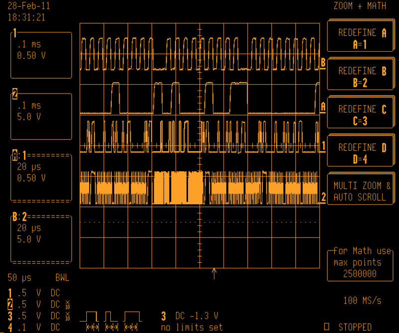

mfcdai2clarge.pngHere are the pulses :
ImageShack® - Online Photo and Video Hosting
A: data , b : clock.
Mark the voltage level on the 9th pulse. They are not correct.
EDIT ( made a local copy of the image.)

Hi Gayan, thanks for the reply.
I"ve added your suggestion in the code, but the slave still does not acknowledge. The master stops sending out bytes and the lines stay high.
I've also changed the Pull up resistors to 4K7,2K2, no advance.
Kind regards.
Found the problem,
An optocoupler betweend the master & slave permitted the master from receiving a ACK.
Kind regards
