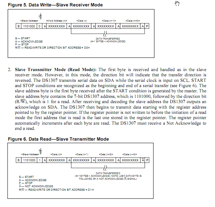

Hello,
I want to have 1 master ( Pic) and several other slaves ( Pic's) and they communicate over I²C .I've been searching for an example ( in C ) , well I found one :
But can someone explain to me how I can find the address of the slave µC and the memory address where I can write data?
in the example the address is A0 and A1 ? I dont know why the address changes , there is only 1 slave.
Thanks in advance

The A0 and A1 define a WRITE or READ to the devices, check the d/s for the command string.

Hello Eric,
thanks for the link, i"ve forgot that the LSB was for R/W. I've learned I²C in school and I was able to make successful projects with I²C.
But I dont know how I can find the address of the slave µC's so I can send data to it.
Thanks!
It should be in the part's data sheet. Because there are so few address options, some parts have two different address options that can be selected by tieing an external pin on the IC high or low. This allows some flexibility if there is an address conflict with another part on the bus.
