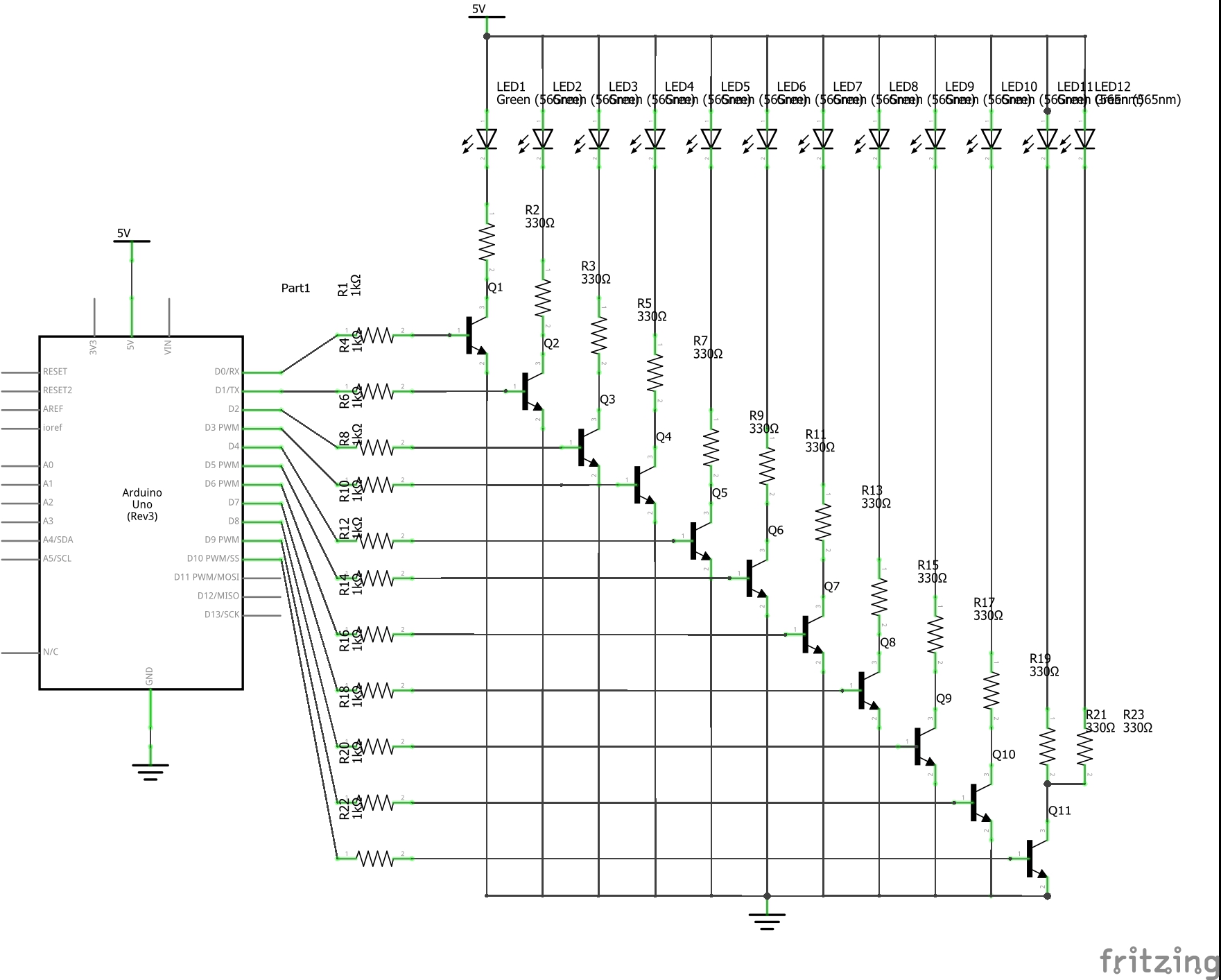

This is how you could make a 12 LED flasher, a small amount of simple programming would be needed for the Arduino.
To increase the number of LEDs you could use more of the aurduino's outputs or have groups of two LEDS together like the last LED chain in this picture.

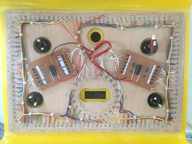

2. The schematic is very straightforward, it would have to be, or I couldn't have built it. There is a pic attached of two such circuits driving 140 LED's built for Christmas last year.
3. The scheme provides the .hex file, no programming is required; surely somebody stateside would have helped him with that.
4. When you add the cost of an Arduino to the cost of shield, I'm not sure whether 'cheap' has any argument or not ...
The above are the reasons I disagree, not the basis for an argument as I bow to your expertise.
S

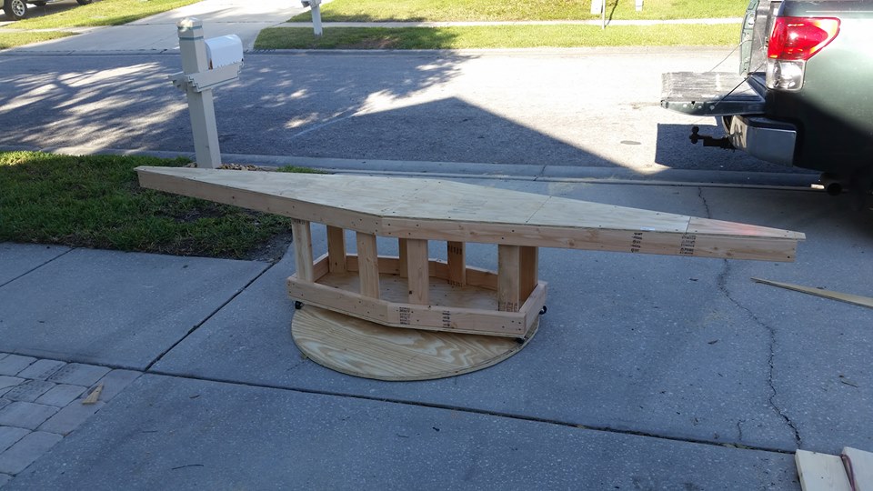

Let me get a picture of the platform. Right now, it is just a skeleton. We were testing some concepts. The prop is a visual effect that spins manually. It is a diamond shape. At times, a member of the Flag Guard (think baton twirler) will stand on the center of the rotating diamond, other times two may sit on the ends of the diamond and spin, other times marching band will manually spin the prop.
I have tried some different "flash" effects using holographic chips and clear coat polysporic sealers (I do some work with epoxies and acrylics for decorative finishes on concrete). From the distances involved, think high school football stadiums and professional baseball stadium, nothing really pops.
Would I be better off identifying the light source first, then determine how to control it?
Again, this is the skeleton. It rotates on a 12" lazy susan with caster wheels for stability. The battery and electronics will sit in the center, there is a solid base. It will get 3/8" plywood sides, and some more framing to extend the sides from end to end. I would install a hatch to access the electronics.

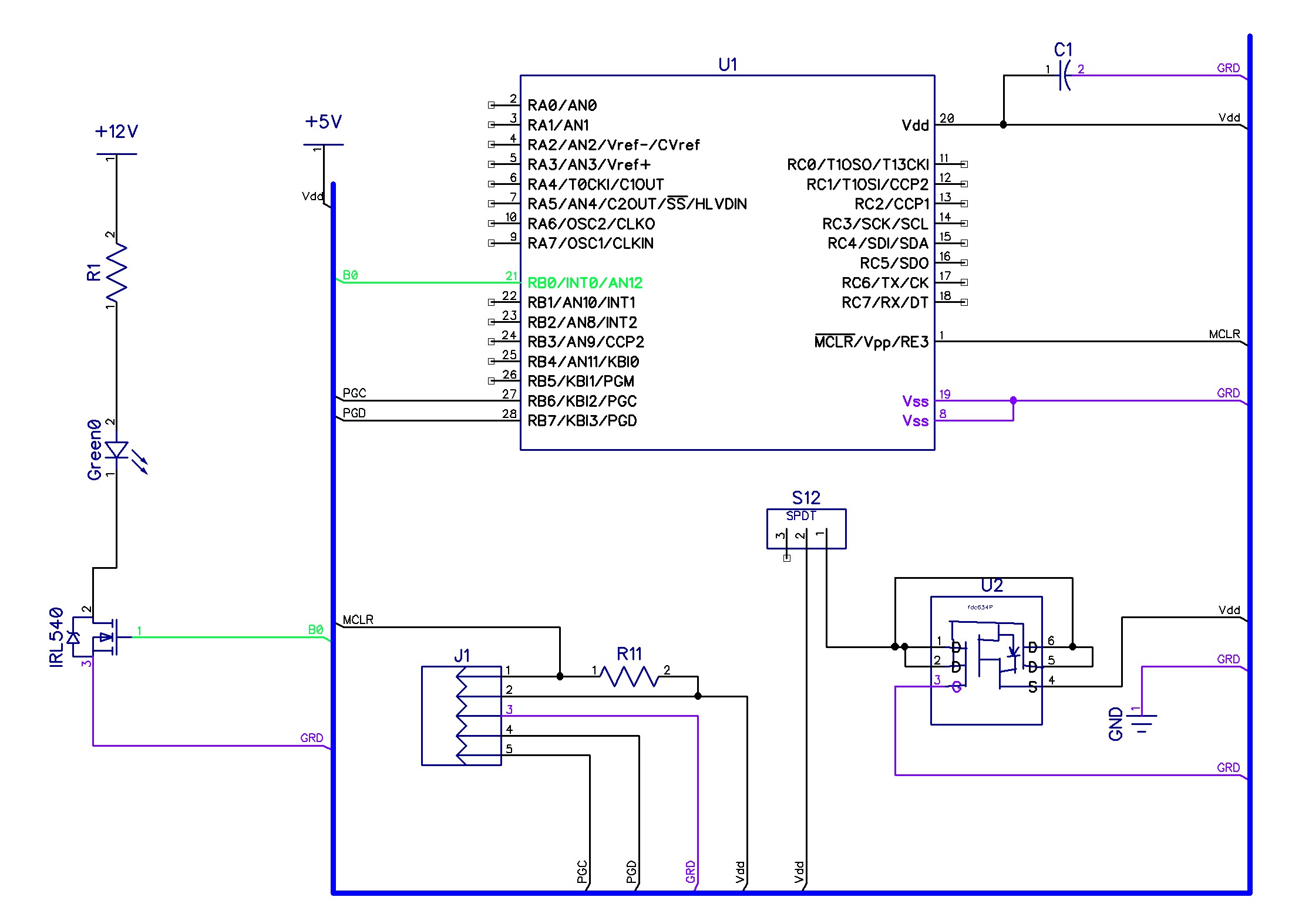

here is a basic circuit using a pic. Programming is not really an issue.
A pcboard could be done to save construction costs and time. The light source is really the issue.
in the schematic, it has only one output but adding additional is easy. This schematic has a reverse polarity protection that is not necessary if going with a pcb but it still needs a voltage regulator section.
I guessestimate about $25-30 per board with 8-10 output circuits.
The pic = $2.50, the mosfet for each led = $1.56, voltage regulator w/ caps = $2, pcboard depending on size of board.
