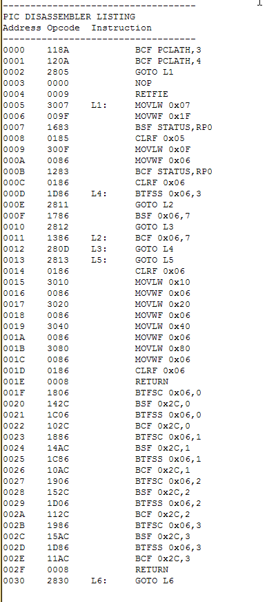

This is a disassembly of a short F628 hex file.
Sorry its in image format rather than text.

Hi Eric, thank you for the image.
Is it fair to assume that I should break my hex string into 8 characters, then decipher these? (based on the image above)

The leftmost column of 4 numbers in that image are the Flash memory 'Address' location where the right side group of 4 numbers, which are the 'Op Code' , are located.
Only the OP Codes are written into the Flash memory at the Address specified.
This is the hex machine code snippet you posted decoded
Addr    OpCode        Instruction
0000    0186        CLRF 0x06
0001    3007        MOVLW 0x07
0002    009F        MOVWF 0x1F
0003    1683        BSF STATUS,RP0
0004    30F8        MOVLW 0xF8
00            ??
