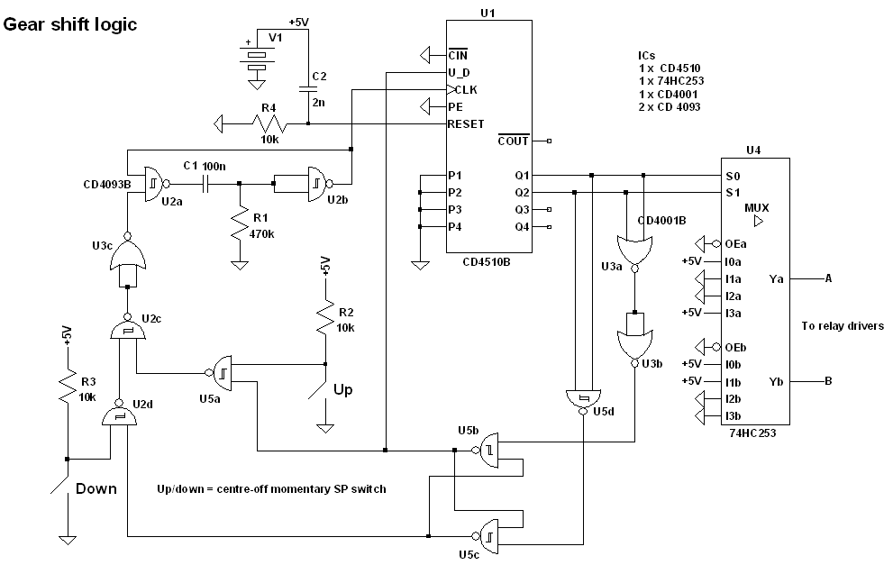

Ive been trying to come up with a circuit design to allow me to use two switches, one upshift, and one downshift, to allow me to manually/sequentially shift an automatic transmission.
2 solenoids inside the transmission determine gear position. They are 12 volt solenoids and current is being handled by automotive relays.
Gear................1... 2... 3.... 4
Shift solenoid A ON OFF OFF ON
Shift solenoid B ON ON. OFF OFF
I will be building a 1-4 counter with a 7segment display for gear display but cant seem to figure out how to do the shifting circuit.
What other information do you guys need from me. Any information or pointing me in the right direction would be awesome.
If you guys cant help is there someone i can pay to create this circuit design? recommendations?
If you don't have any experience with building circuits the simplest way would probably be to use a small micro controller, one could easily drive the four relays (via current bypass transistors) and the 7 segment display with little effort. You could probably do it with digital logic gates but that's not my forte. You may want to be on the cautious side, because if something goes wrong with your circuit at high speed and the circuit accidentally shifts into first gear because of a bug there's a good chance the engine will blow... That's a VERY expensive way to play with electronics.

A microcontroller would be the way to go. Excluding the requirement that other things need to be controlled and you want to do it w/o a microcontroller, you can cheat.
1. First there is a 1-4 up/down or 0-3 Up/down counter and add 1. But then you have to disable up when you reach 4 and disable down when you reach 1. Then you have to preset the counter to neutral (conditions) and you forgot neutral, so is that 0-4 where 0 is neutral. 5 states you can't get with two bits.
2. There is an easy way to CHEAT with logic functions, but the right way is to use a Karnaugh map to generate the truth table. Cheating involves using a data selector/multiplexor. You basically use the 2 bits of your counter as the address input of the data selector and you tie the input point of the data selector to whatever you want the output to be. Thus you can do the design with 2 data selectors (one for each solenoid).

91 240sx transmission is a RE4R01A

Other functions are controlled through hydraulic pressure only available when shifted into those locations. I'm still going to have my factory gear shifter. It controls what circuits get hydraulic pressure. This is why my questions only involve a logic circuit design and not "what else do i need to worry about"....since i already know everything else and have it all handled. I'm not going to come in here and blame people for helping me if I don't perform my own due diligence and hurt some other mechanical part you guys have nothing to do with.
Then engine is running on its own standalone ecu from AEM and is currently controlling the transmission and working great. I want the ability to enable a "manual" mode in the aem and then pull on a totally separate handle to upshift and push on the lever to downshift whenever i want.
So a microcontroller is the way to go? Point me to any certain model? Whats the output pin going to output? Do i have control of that?

line pressure, lockup and overrun clutches are all being properly controlled through the aem right now. Still just need the above circuit only.
I guess there's no way I can tell you how educated i am on the issues your guys are concerned with. How uneducated i am on building a circuit to perform a desired task.
What about building a circuit that selects an output voltage with 2 switches. If i tell the aem gear one is 1 volt dc and i input that into an acdr input the aem will then output correctly the gear desired. so gear 1 1vdc gear 2 2vdc gear 3 3vdc gear 4 4vdc....then select the output voltage by the switches. Whats easier?

There is a 2d table with y axis being voltage and x axis being gear. So I can tell the AEM any voltage being any gear. So that being said IF the AEM sees a voltage at the (for the sake of our discussion) "gear" input it determines this voltage looks at the table and selects outputs the gear desired through two low side drivers.
Right now i have 5 low side drivers coming out of the AEM to 5 relays and controls:
lockup
line press
overrun clutch
sol A
sol B
dependant upon tps is when i enable line press to go up.
Theres a table for gear desired vehicle speed vs tps. This table controls "gear desired" and the AEM is told (by me through the tuning software) what duty cyle to output to what low side to be a certain gear.

I dont really care how its done. I just want to push or pull on a sweet gear lever just next to the steering wheel to sequentially select gears.
I have a feeling that what you are asking for has been discussed before, try this thread. I designed the bulk of the circuit and while it was designed for 3 gears, Park, reverse and neutral, it can easily be modified to include an extra gear. The code however keeps returning errors when I try to run it through MPLAB so I need to do some work with that. It shouldn't take too long to correct the errors, I can probably have it done in a couple of hours.
Here's one possibility to get the A and B outputs.

will this follow the table i posted earlier? and what voltage are the outputs.... 5v or ground
Yes. Output is logic level (5V = 'relay on', 0V = 'relay off').
I've attached the asc file if anyone wants to run the simulation.
Edit: I haven't included in the schematic a BCD-to-7-segment decoder which would be needed to drive a display.

LTSpice. It's a free download from Linear Technology's site. Recommended.
downloaded the program LT spice IV and installed and opened file SCAD3 and opened gearshift.asc and it gave me this error
Couldn't find symbols:
CD4510B
DVIEW5
74HC253
CD4093B
CD4001B
