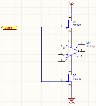

Is there any way to enable/disable an opamp by means of controlling its supply voltage. I want to make opamp run in normal mode when both FETs conduct, and make opamp output high impedance when both FETs are cut-off.
My idea comes from the fact that, most opamps have output driving circuits same as the image below, or can be characterized like that:
My purpose is to desing an "analog multiplexer", after seeing how expensive analog multiplexer ICs are, I decided to desine my own circuit.
There will be several opamp ICs on the board, and a microcontroller is going to select an analog source by enabling one of those opamps. Though there is a problem in my desing: I won't be able to use a quad opamp package.
So, any ideas, could it work?
I don't think you could switch an opamp to a high imepdance state like that, you'd have to remove it from the circuit entirely. You could use FET's on the output of the opamp, but the opamp is still going to be connected and active to the input, the FET would just be switched off to keep the output from going anywhere.
If I could manage to make the output of a disabled opamp 0V, it satisfies my needs. I can input all opamp outputs to a suming circuit. So the disabled opamps would not effect the output of the summing circuit.
Looks weird... You can get opamps that have an output enable pin which should do what you speak of. Or just use a cheap analogue switch/MUX IC: e.g. (74HC)4066, (74HC)4051
So they use a mosfet on the opamp output.

Cheap? Can you give me some numbers?
I search it in Farnell, the typical prices were above 25-30€.

Those numeric characters in my previous post were the part numbers.
In the UK they are 27p each
Ok, now I understand that analog multiplexers are not that much expensive. Maybe those I found at Farnell were some special function multiplexers.
I decided to consider this analog mux idea. Can you please tell me the performance of analog multiplexers? I know that it is impossible to transfer a signal keeping its exact from after passing it through a semiconducter circuit element. How much my signals will be modified after being switched by an analog multiplexer? What is the level or percentage of sensitivity?
I read datasheet of 405x family (x=1,2,3), There is no clear indication about this matter. I am new to this analog multiplexer thing, I don't even know their working principles.
Maybe check the datasheet for that.
They're supposed to exhibit a pretty good transfer characteristic of a resistor. I do know that most have a varying resistance depending on the voltage passed - so as long as they're driving a high impedance device, there should not be any issues.
Three important characteristics of analog multiplexers to note are: on-resistance, signal amplitude for normal operation, and switching speed. These are noted in the multiplexer data sheet.
