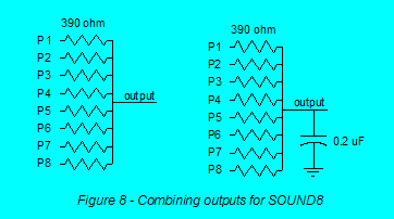

i just got an idea to make a music
using PIC , to make it work i find
a shine wave circuit which it use a series of resistor
every time a resistor hit other resistor it will make a
different sound
but i didnt not really understand how to programming
the PIC , im still developing the program but i have some
question .
how to moving the high output
from pin to pin
without delay but every time the pin is high it
will play within 0.5 second
, i following some blinking led script and changing some code
but i still dont understand about this
because to blinking led its only use one pin
but the shine wave uses many pin
if anyone could help me on this project
it would be helpful

The command to make music with eight "voices" is "SOUND8", and looks like
Example
dur1 con 2
dur2 con 1
nA con 440
nB con 494
nC con 523
nD con 587
nE con 659
nF con 698
nG con 784
nA2 con 880
sound8 outl,[dur1\nc\ne\ng,dur2\nf\na\nc\a2]
This program first defines nA – nA2 as the musical notes (equal tempered scale) A, B, C… A2 respectively. Then it plays the chord C-E-G for 2 seconds (on pins P0 to P2), followed by the chord F-A-C-A2 for one second (on pins P0 to P3). The remaining pins on the port remain silent. Of course, flats and sharps can also be defined; a quick internet search will give you the frequencies you need.
Pretty simple, huh?
A quick schematic for the summing circuit, and there you have it!
kenjj
