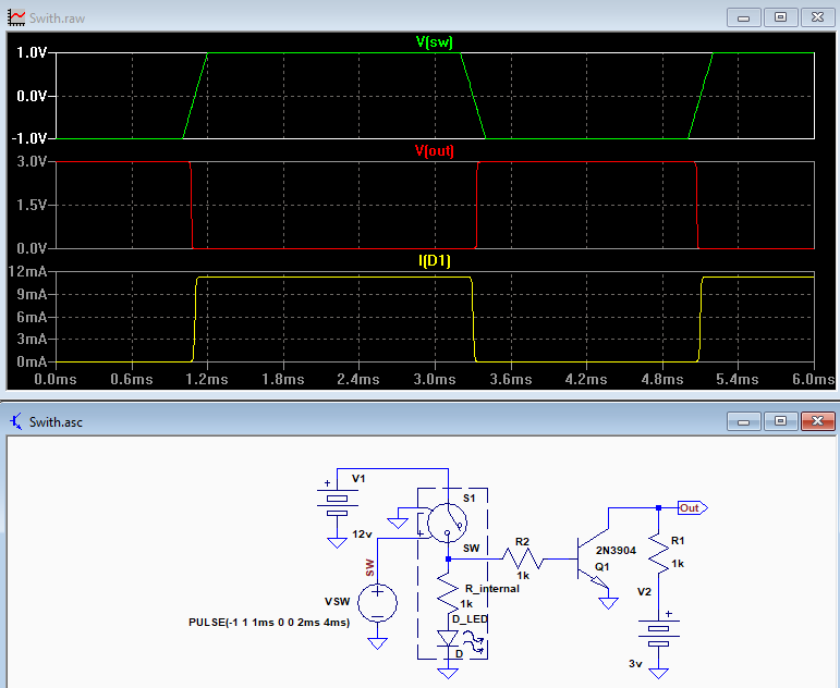

I have a SPST LED rocker switch that is being used to connect ~+3V to GND on a DVR. Doing this turns on the DVR and begins the recording sequence. The problem is when this is done, the potential is nearly 0V and can't be used to drive the built-in LED! If I have an external volage source, is there a simple circuit that would allow me to tie the 3V to GND but also allow the LED to turn on when the switch is closed?

You can't do it with those switches without a relay. You need a switch that will ground the terminal and the LED.

I'd prefer to use these switches for aethetics as I've already used a number of them in a project, but don't have this issue since they all work off 12V. How would I set up a relay? Thanks!
Here's my take on a circuit to do what you want based upon my understanding of the switch.
It requires the addition of Q1 and R2.
The LTspice simulation shows current through the LED (D1) when the switch (S1) is closed, which lights the LED and turns on Q1 to short the 3V signal to ground (Vout).
R1 is an assumed resistor in the circuit and R_internal is the LED resistor inside the switch (switch is inside the dashed line).
You would power the relay like any other device and have the relay ground the 3V line. Or, as mentioned above, use a transistor to ground the 3V.
