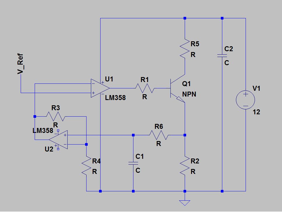

The problem: I have a DC 12V 200mA power supply that I want to convert to a DC 12V 10mA supply.
The application: I want to use this supply to power 2 amplifiers (one instrumentation and one operational) that I want to used to regulate the output of a load cell (they output 3mv/V). So I have done some research and by using these amplifiers I can get the output of the load cell to be between 4-20ma (standard) but it had not occurred to me that the amperage of the power supply would be a problem (I have used op-amps before and never had a problem with amperage). So it all comes down to how can I reduce that 12V 200mA supply to 12V 10mA without frying any components (the end product will be left running for weeks at a time). So power dissipation is also a concern.

While I, reading your description above, cannot understand why you need to limit your power supply current to 10 mA, I can suggest a method of doing so. Refer to the attached image. Your load cell is represented by R5. Resistor R2, is a very low value resistance, say 1R. Suppose that the max allowable current of 10 mA passes through the load. The same current would pass through R2, and create a voltage of 10 mV across it. The non-inverting amplifier comprised of U2, R3 & R4, whose gain is 1 + (R3 / R4), amplifies this low voltage to, say 2 V (so R3 / R4 is 199 in this case...choosing R3 = 200k & R4 = 1k would achieve this). R6 and C1 are to reduce high frequency spikes produced in the load cell for whatever reason; suitable values are R6 = 10k & C1 = 10uF.
V_ref is the current control reference voltage. Set this to 2V in line with the component values selected so far. Op amps U1 & U2 are the two halves of a LM358 dual op-amp IC. R1 is around 2.2k and transistor Q1 can be any general purpose NPN, eg 2N3904, 2N2222, BC239, BC547 etc.
Circuit operation is straightforward. When the current thru' the load exceeds 10mA, the voltage at the inverting input of U1 will exceed the V_Ref of 2V. This will cause the base current to Q1 to fall, which in turn will cause the load-cell current to fall. Conversely if the load-cell current falls below 10mA, the voltage at the inverting input of U1 would be below the V_Ref. This would boost the NPN base current and thence boost the current through the load-cell.

Wow, I did not know that at all. I guess I did have that misconception. So then if it will force 12V on the wire how is the amperage that it will push determined?
Also will there ever be a situation when it will try to increase the amperage?
My concern here is that the amplifiers have a maximum rated amperage they can take and exceeding that would blow them.
The amperage is determined by the load. (As long as the supply can handle the load.) It sounds like you supply is 5 or 10 times bigger than the load. That's a good thing.
Example: You have a amplifier that is rated to pull 10mA, (probably less if it is not working hard), and maybe a little more if it is working 'fast'. That 10mA is probably worst case and could be 5mA average. In your case you need to use worse case numbers. If you had two of these amplifiers then they together could pull 20mA total, but more likely less because we are talking the worst part. Your 200mA supply can power 20 of these amplifiers all at the same time.
