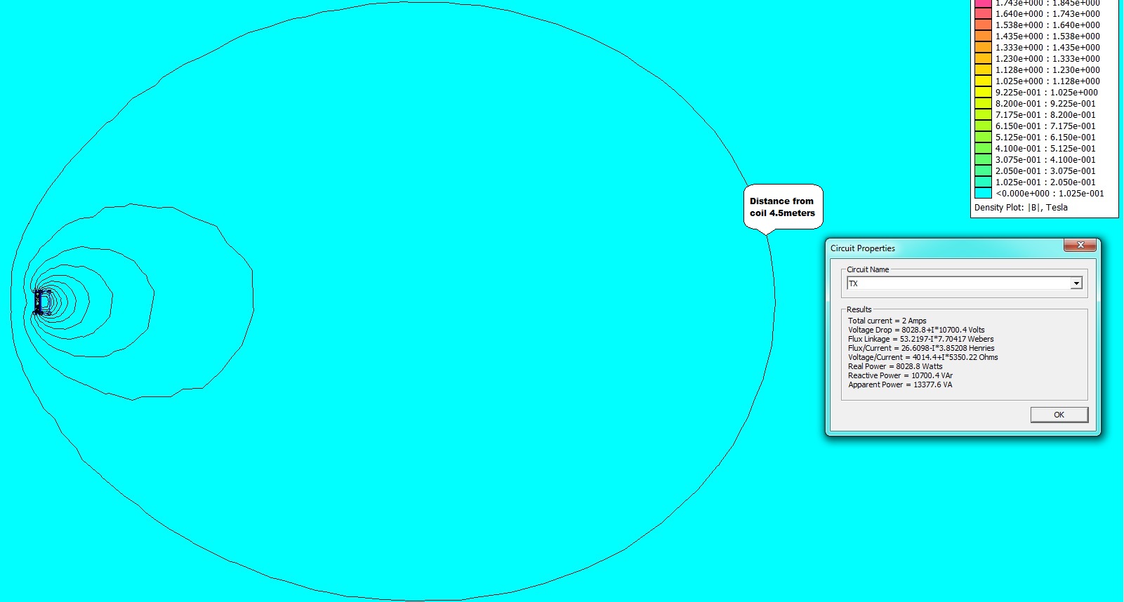

When I do testing I just connect both ends of Rx coil to the scope , I get very strong signals when Rx coil is line with either end of Tx coil because iron core amplifies the Magnetic field on both ends of Tx coil . I did some FEMM simulation and it shows that magnetic field should extend outwards beyond 14-feet . But I don’t see any signal or the FFT function of the scope doesn’t show any spike at 25Hz beyond 1-feet , although when Rx coil is inline with the end of TX coil I do see signal embedded in the noise . But my requirement is that Rx coil should detect 25Hz when place 12-feet away in length-wise parallel to the Tx coil .

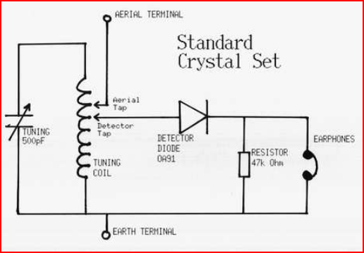

How about something like this: http://electronics-diy.com/am-radio-transmitter-using-555-chip.php
You would feed your 555 25kHz signal into the "Audio +" and Gnd.
For a Receiver (at its most basic):
Crystal sets take a bit of tuning, but this would work for your purposes, such as I understand them. You can buy them online for practically nothing.
Keep in mind that your are flirting with RF here, which generally requires some manner of an FCC license. But, at the signal strength you're likely to produce, it should not be a problem.
You would, in your case, eliminate the earphones and attach your scope probe (or whatever) directly to the Detector output.
<EDIT> If you were to use a simple "Ferrite Coil" type AM radio antenna, for both your rx and tx circuits, I think it'd work quite well.

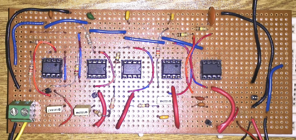

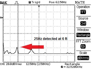

Here are the results of testing Rx coil with a 8-order Sallen-key active filter , on the last stage of the circuit i ran out of accurate values of the capacitors or the sales guy from where i bought it didnt had 5% capacitor for those values , bottom line is it did cleaned the signal , but time domain trace dosent show anything except for over-riding noise, only when i plot FFT i see a nice spike at 25Hz at a distance of 6ft . see pics attached

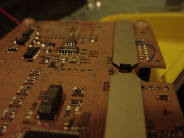

Actually my approach to extend the range of sensing is wrong to detect magnetic field at a distance of 12ft or more a Hall-effect sensor is used and to channel field into sensor metal strips are used to direct field into its sense axis , they work at low voltage and also Tx coil doesn't have to running on very high voltage and current , see pics attached
Looks interesting. When i was experimenting with the linear hall effect devices several years ago, i found that any metal at all was better than no metal. Even one of those steel binder clips would help increase the sensitivity, but i also found that if you clamp one onto the hall effect device it breaks the plastic package as the plastic package can only take so much pressure before it cracks.
