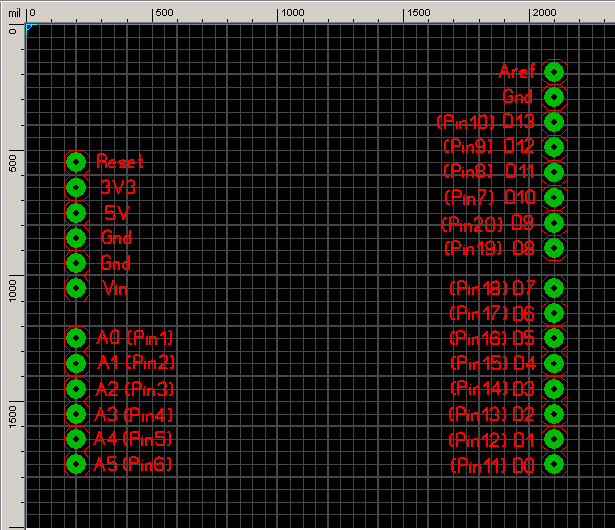

Well as the Arduino pinout on boards are weird spacing I just made up a temple and saved it as a macros so when I want to design a new shield board I won't have to manually go thru the pain of the spacing again.
View attachment Duinomite Pinout.zip I zipped up the macos just to make it sure it would attach.
Now here is a picture of it with the pin numbers matching the DuinoMite board
Regards Bryan
