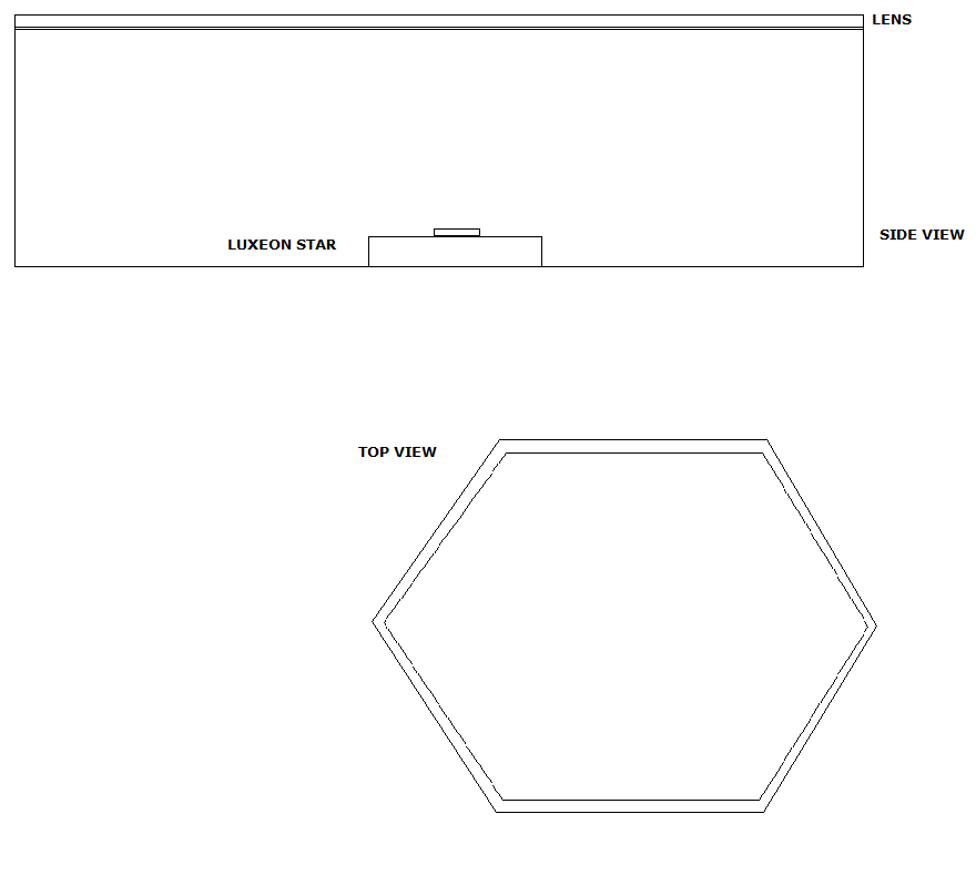

Im making a light at home, but I have a problem with it. The luxeon star being used to supply the light creates a large bright spot on the top lens in the center, and leaves the rest of the lens mcuh darker. I now need to make a lens to sit over the luxeon star which will defract the light so it lights up the top lens evenly.
Attached is a picture of the light that I made it paint to explain myself better. Im really after the shape of lens that would be required to bend it away from the center (which is where the bright spot is).

The LED has a single point of light. The center of the lens is closest to it so is brighter than the edges of the lens which are farther away and so are dimmer.

It sounds like you need a diffuser, a semi-transparent plastic cup or bowl will do.

Ive tried this, unfortunatly it just illuminates the bowl, and still leaves a pretty solid birhgt spot in the center of the lens. :s
Ok, what would be the best approach, minimizing the light loss.
What about if I used strips of shiny material (nearly polished stainless or aluminum, or metallized plastic, etc.) to reflect light from the center out to the sides?
Also apprently my luxeon has a beam of 140 degrees, but i guess its so close to the lens that I still makes a substainal bright spot.

the Luxeon III Star (3W) and the Luxeon V (5W) have an almost linear radiation pattern of 150degrees, which is 100% along the optical centerline and decreases to 80% 75degrees left and right of it.
To distinguish between the wide band of decreasing brightness it takes measuring devices much more sensitive than a human eye.
If you have a bright spot along the optical centerline of your Luxeon it is definitely NOT a Luxeon.

The screen on top lights up from the LED. The screen lights brighter when the LED is closer, directly below.
The screen lights dimmer at the sides where the LED is farther away and its light is spread over a larger area.
I think even an incandescent light bulb or a compact fluorescent light bulb would produce the same problem.
