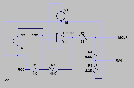

I am learning to use LTSPICE.
For kicks and giggles I started with the MCLR generation section of the Stoltz ICD2. Got that working using generic PNP and NPN transistors.
Now I want to try Stoltz's opamp version of the same.
I did not see the LM358 opamp it in the list. There are several generic/universal opamps. Should I use one of these or hunt for the part somewhere?
Is there some way to have the schematic redrawn with the voltages shown after a run. It would be easier to use then the text list of nets.

You can run the simulation with an LT1013. It's a dual precision op amp that works with single supply and it can be used as a replacement for the LM358.
I suspected that was the case.
Found several places on the net that have models for the LM358 but am unsure of how to use the files so LTSPICE can see them. So far the tutorials I have looked at do not go into adding new components. A pointer to one that does would be great.

Using most P-Spice-type models with LTSpice is easy. They're usually subcircuit-type models. For an opamp model, there's already a handy existing symbol you can use, "opamp2" in the Opamps library. Plop it onto your schematic, right-click on it, click in the "Value" column in the "Prefix" row and then enter X in the "edit box", above the table (X tells the program it's a sub-circuit model). Then click in the "Value" column of the "Value" row, and enter the subcircuit name (e.g. LF358), as it appears in your model file. Then, on your schematic, place a spice directive (with the .op button) like .include yourmodelfilename.sub, where sub is whatever the filename extension is (Often, it's sub, but needn't be.).

Tom,
Thanks for all the info.
I need to run through a few tutorials. But if someone sees a obvious blunder here please point it out. Please do not spend time on this unless you enjoy doing so.
I created the opamp version of the MCLR circuit usng the LT1013 and ran it using .op In the status at the bottom it displays "Stepping 98.9466% Step Size =..".
Thinking this is because the opamp has feedback from output to the inverting input. Never get to a steady state using .op. ??
The log has a hint about using .option noopiter but it did not change anything that I could see.

Nice catch, Ron! Every once in a while, I STILL do that to myself. Not connecting power to some opamps is another one that still gets me, occasionally.

You probably already know all of this. But... With other convergence problems, it's sometimes beneficial to un-idealize certain types of components. I always add at least a small amount of ESR to caps, and DCR to inductors, for example.
Other times, you might have to go into the Control Panel's Spice tab, and try the Alternate Solver, and/or mess with Gmin, Trtol, etc etc.

If you have the model of an LM358, try this: save the file in the "sub" folder, as "LM358.sub". Choose and place an "opamp2" and enter "LM358" in the "Value" field. Add the directive ".LIB LM358.sub" to your schematic and try running the simulation.
This works for almost any subcircuit. For some, you will have to copy the subcircuit from a web site or forum posting and paste it into notepad. Save it (as eng1 says, in the "sub" folder) as file type "All files". The caveat here is that it if you accidentally (or intentionally) save it as type "*.txt", it will actually get saved as "LM358.sub.txt". To see this in Windows Explorer, you need to go into the Tools dropdown menu, select "Folder Options", select the "View" tab, and uncheck the box for "Hide extensions for known file types". The saved file must be renamed as "LM358.sub" (or whatever".).
Another caveat is that the subcircuit needs to be given the same name in the value field for opamp2 as it has in the file. For example, the National LM358 file "LM358.mod" names the subcircuit "LM358/NS". You can either enter this in the "opamp2" field, or you can edit the subcircuit name in the file and re-save it. You may also have to rename the subcircuit name in the ".ends" statement if it occurs there.
