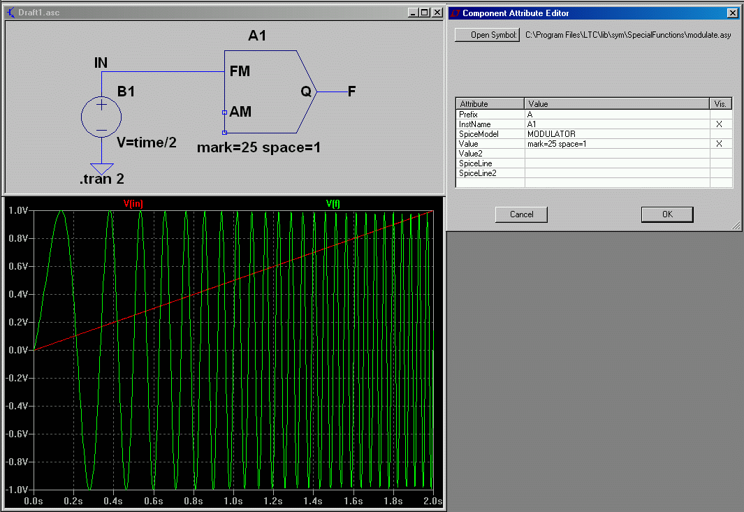

LTSpice simulation.
I could not find a way to implement this:
a) Testing a circuit fed with a fixed amplitude sinusoidal voltage source varying frequency along a certain period. Say, in 2 seconds, between 6KHz to 450 Hz with 0.5 V amplitude.
b) Later I would like to test the same circuit in the same period at a fixed frequency with a varying amplitude.
c) And last, eventually, mixing both options.
Is such a thing possible? I fear I am out of luck here.

Have you tried the 'modulate' device (in the SpecialFunctions folder)?
The test you propose sounds like a .tran analysis to me, but you say it isn't? :confused:
The sim in the previous post is a .Tran. B1 makes a voltage that goes from 0V to 1V as time goes from 0s to 2s. The Modulate behavioral component makes a 2Vp-to-p signal which is 1Hz when the FM input is 0V (space=1) and makes 25Hz when the FM input is 1V (mark=25).
Thanks to you both for replying and sorry for saying the oposite: I was effectively trying to do a .tran simulation (avoiding an .ac simulation). :banghead: :facepalm: :arghh:
I understand you call this "a senior moment". We have a couple of colorful expressions on this regard as well.
