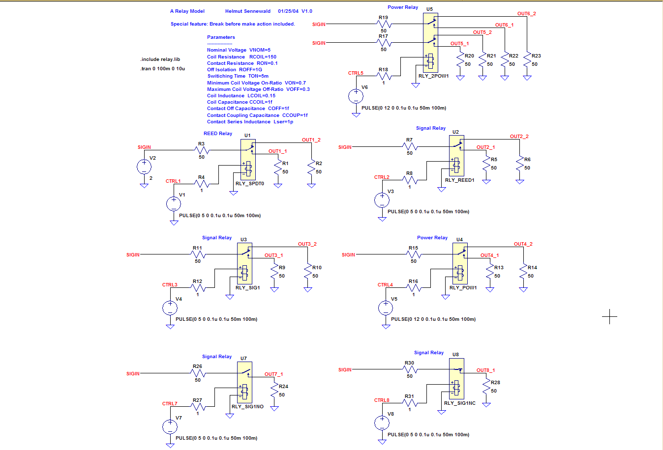

Yahoo LTS group has switch models.
EDIT:

You can simulate a DPST switch using the swtiches provided in LTSpice. It can get kind of messy, but you can hide the details in a custom component.
Or jsut use realys as Mr EG suggests.

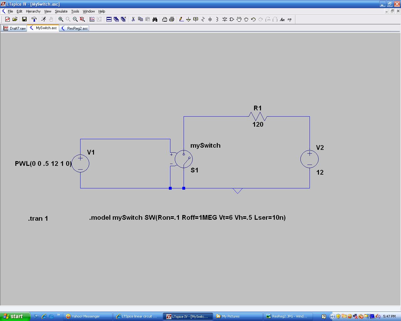

Here's a schematic that uses a switch in LTSpice. You have to chose the switch from "components/sw" and use the .model statement as shown to define the switche's characteristics. You can simulate any switch by connecting the sw primative in various configurations, and as I said, hiding the details in a custom symbol.
I have used two spst switches as a spdt switch. I wire the inputs together so they get the same voltage. In the .model statement I set one switch to have an on resistance of 1 ohm and an off resistance of 10,000,000 ohms. The other switch has a on resistance of 10,000,000 and an off resistance of 1 ohm. This causes the two switches to act opposite to each other.
