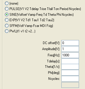

*I couldn't create AC source.
Right-click on a voltage source, click "Advanced" and enter the AC properties.

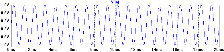

I've tried that, but there are a lot of settings. I know the amplitude, frequency, DC offset. Some I left blank. But I couldn't get sinewave.
Besides, what's the setting of the simulation time usually?
Thanks :)
That's enough to generate a sin wave. See the pictures below. I plotted a 1000 Hz sine wave, the amplitude is 1 V. You can choose the "Stop time" for the transient analysis in order to see a few periods of the wave. In my example T=1/1000=1 ms and the stop time is 20 ms => 20 periods

I should have got the sine wave, I put 1 kHz frequency, but the simulation stop time was 4 us, LOL :D that's why I got a straight 0 V.
Thanks dude.
