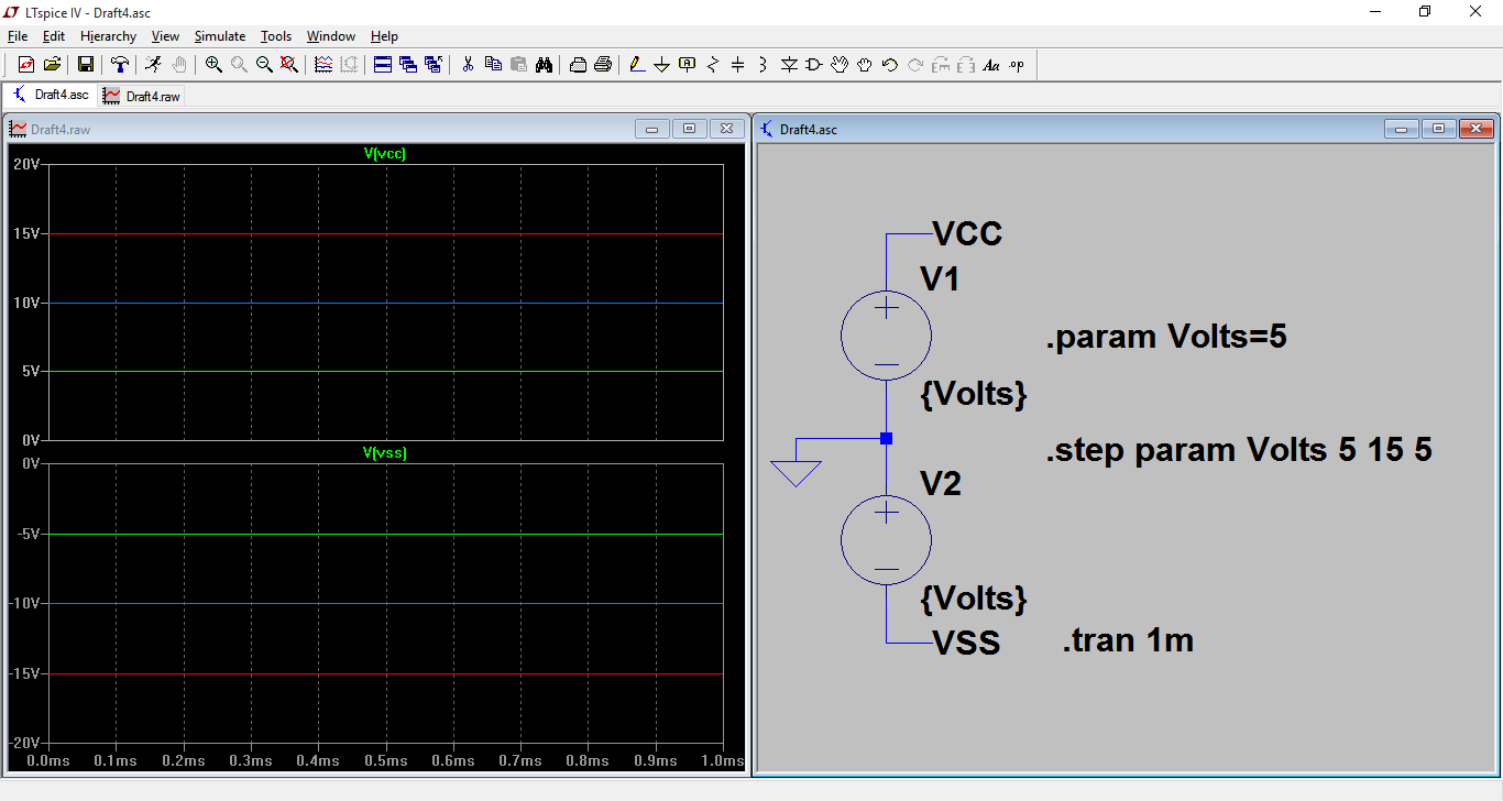

I was playing with LTSpice and op-amps that needed a bipolar supply. I did it in a way that was obvious to me. Then, I checked Linear Technology's models. This is what it does:
That is just not intuitive to me. Anyone else have a problem with it? (I am not arguing. It is easier to do.)

Hi
I think if you look at enough models its done different ways.
I connect a split supply this way. You can use the same parameter to set different voltage levels

Thanks for the model. I looked and did not see it. I am sure that won't be the last time I miss something obvious. ;)
Your way of handling the bipolar supply is similar to what I did at first. That is, I followed the intuitive meaning of the supply symbols. Then, when nosing around for the correct spice model, I looked at a Linear Tech "subcircuit definition" . That is where I found the image posted originally. Both "designs" worked. I was just wondering whether there was some explanation for the Linear Tech symbol other than my assumption (post#3) that it's the directives, not the symbol that matters.
John
I usually do my dual supplies the same way as etech.
That symbol is initially confusing when used as per post #1 and also when designating an AC source!
The 'signal' symbol in the 'misc' folder makes you think, too!
capture-png.95780
This is like installing one of the batteries backwards in the battery holder.
Some very old cars had a 6V battery and a positive ground. (+ ground) NO the car runs on -6V.
