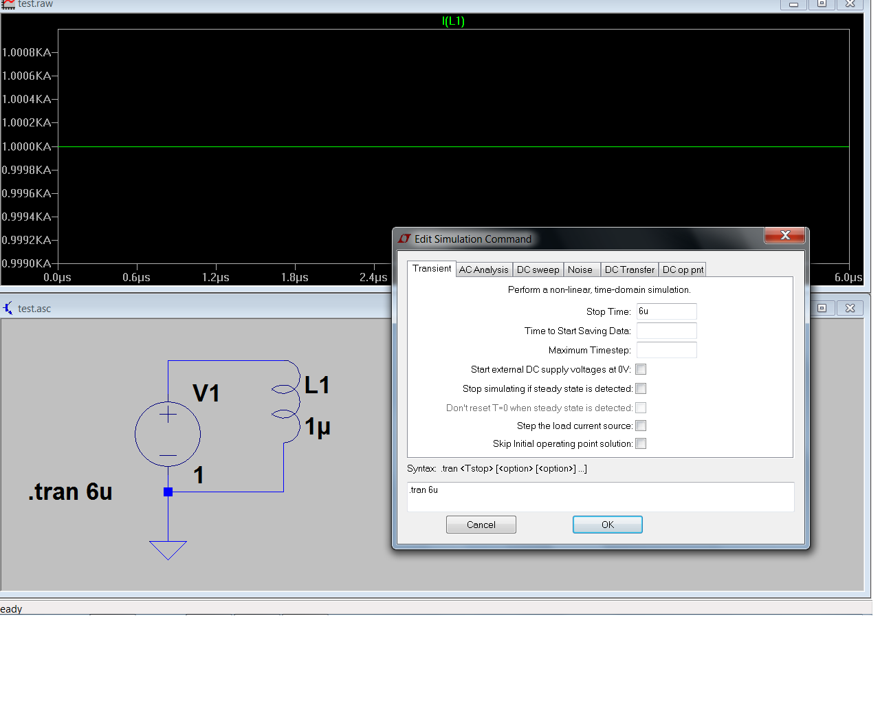

:sorry: hi i'm tracing the current through a 1uH inductor but it looks like the trace of a 1mOhm resistor. can someone tell me what i'm doing wrong?
thanx, mike
Welcome to ETO!
Add some resistance in series with the inductor. 1000A is a tad unrealistic!
Welcome to ETO!
but even an ideal inductor is supposed to have inductance, right? like VL = di/dt there's supposed to be some opposition so i don't get how it arrives at the 1kA number. <edit>and it STARTS at 1kA. i backed up the time scale to ns, to ps. it's starting at that value</edit>

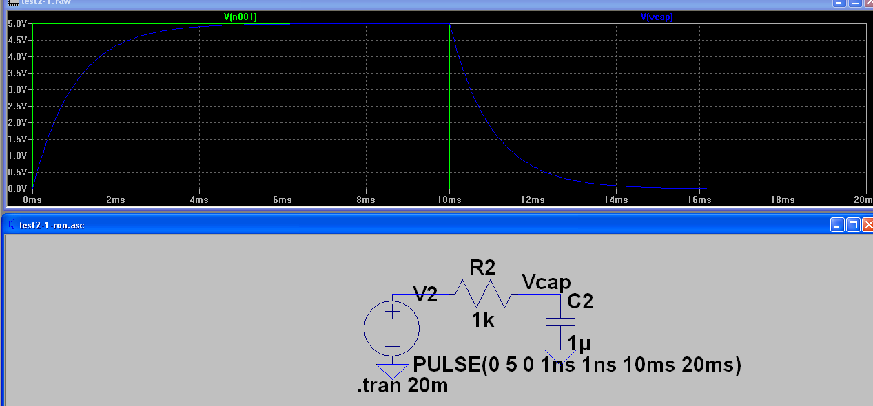

Changed 1F cap to 1uF.
Changed your voltage source from a battery to a pulse source.
"Initial condition" is one of the problems. The program saw the voltage on C1 was going to charge to 5V so it started out with the voltage at 5V.
By using a pulse source, I started out with 0V, at time zero moved to 5V, then at time 10mS moved back to 0V.

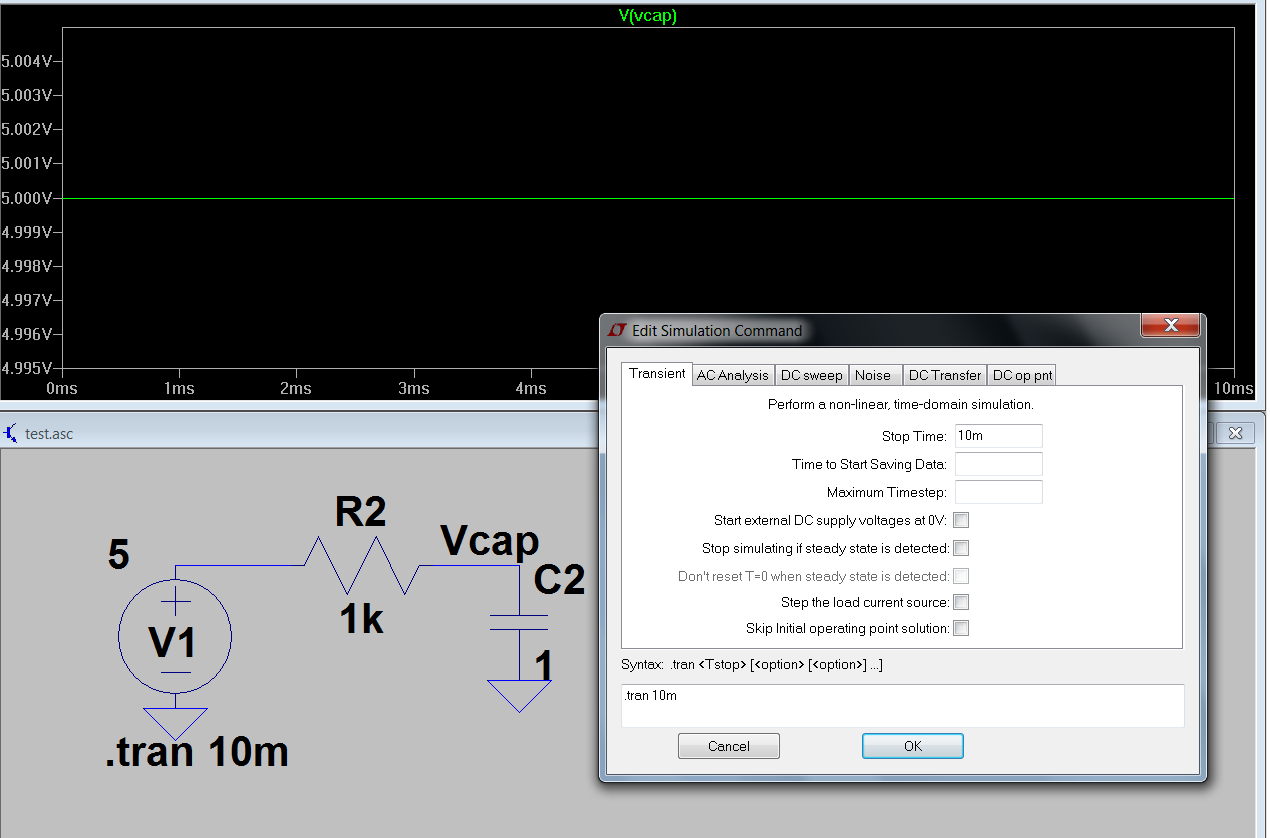

i don't understand. voltage V1 is supposed to start at 5 and the voltage at Vcap is supposed to start at 0. so spice is just not plotting what i'm telling it to plot. but when you change the voltage source to Pulse, then it interprets the circuit at face value and plots it correctly. WTF?
No.
If this was true then a simple amplifier circuit will need time to "stabilize" before you can look at it. (example the capacitors on the power supply) What spice does is try to determine a steady state for your circuit. In your case it will start out with 5V on the cap.
What I did was to make a voltage source that goes 0,5,0 volts. (note the first 0 is for time before "o")
ok Ron thanx. so it's making an assumption about what i want to see. but with a 1F cap, that's QUITE an assumption.
the first zero is the initial voltage?
is there a more direct way to specify initial condition?

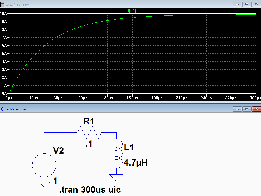

yes it was, just to see how long to saturate an L of 4.7uH so i could make a buck circuit. but why would i need a step voltage function i don't get it.
You need a step function because Spice normally calculates the steady-state DC bias conditions before it does the transient response.
To prevent that you can start the simulation without that calculation by using the uic,
, in the Simulation Command.
The results then are:

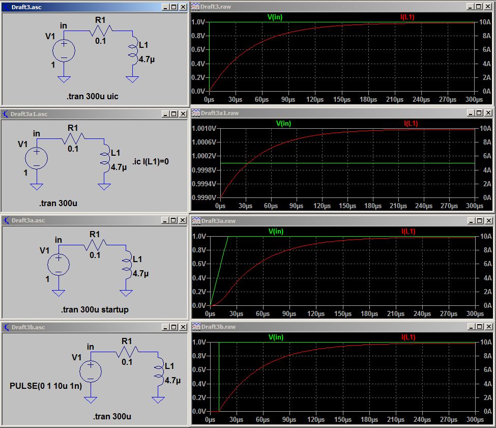

Further expanding on Zappers posting: Here are four different ways to do this. 31a and 3b are the preferred ways. 3 and 3a frequently have undesired consequences...
