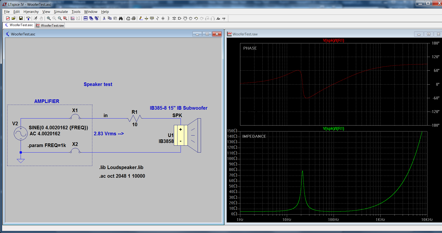

Hi
Someone here expressed interest in using spice models of loudspeakers.
I've uploaded a loudspeaker library file, with symbols, and test circuit.
Instructions for adding models to the library is contained within the file.
I've also uploaded a snapshot of test circuit and impedance plot.

The impedance curve of the woofer is interesting but the fact remains that this is due to mechanical resonance and is taken in free air. A woofer used in free air would be an interesting thing to see? The whole purpose of an enclosure is to control the cone resonance so that in real life, the impedance plot looks NOTHING like the free air plot. The purpose of the free air plot is to determine the electromagnetic damping of the loudspeaker itself. This plot is then modified by the effect of the enclosure; and the air loading of the enclosure is selected to control the Q and frequency of the resultant cone resonance. The amplifier output impedance also plays a part in the system and is used to provide the optimum electromagnetic damping of the SYSTEM.
Just not sure that spice is able to do all this.
The Thiele/Small parameters are what is needed to do the job.
Hope this helps.
I speaker is greatly effected by the enclosure at and near resonance. The modeling was done to match the data sheet, not the speaker in a certain box. eTech did a great job of matching the data sheet!
This project started out looking at crossovers not speakers. I objected to studding a crossover network where the speakers are '8 ohm resistors'. We were really only looking at the frequencies where the power shifts from one speaker to another. We only needed to model the inductive part of the base speaker. (only looking at the top end of its range)
I would love to see (some one not me) make models for ported boxes. That is beyond this project.
I do not want to sound like I disagree with Rumpfy. I agree with Rumpy.
Whilst I've not looked at the contents of the zip, the impedance plot looks perfectly reasonable for a sealed box (is this what's implied by the IB in the model name?). The impedance plot of a sealed box will have the same general shape as that in free air, since the compliance of the box volume simply modifies the compliance of the driver suspension. Put another way, a sealed box is a system with only one reactive component and so can't contribute a resonance of its own.

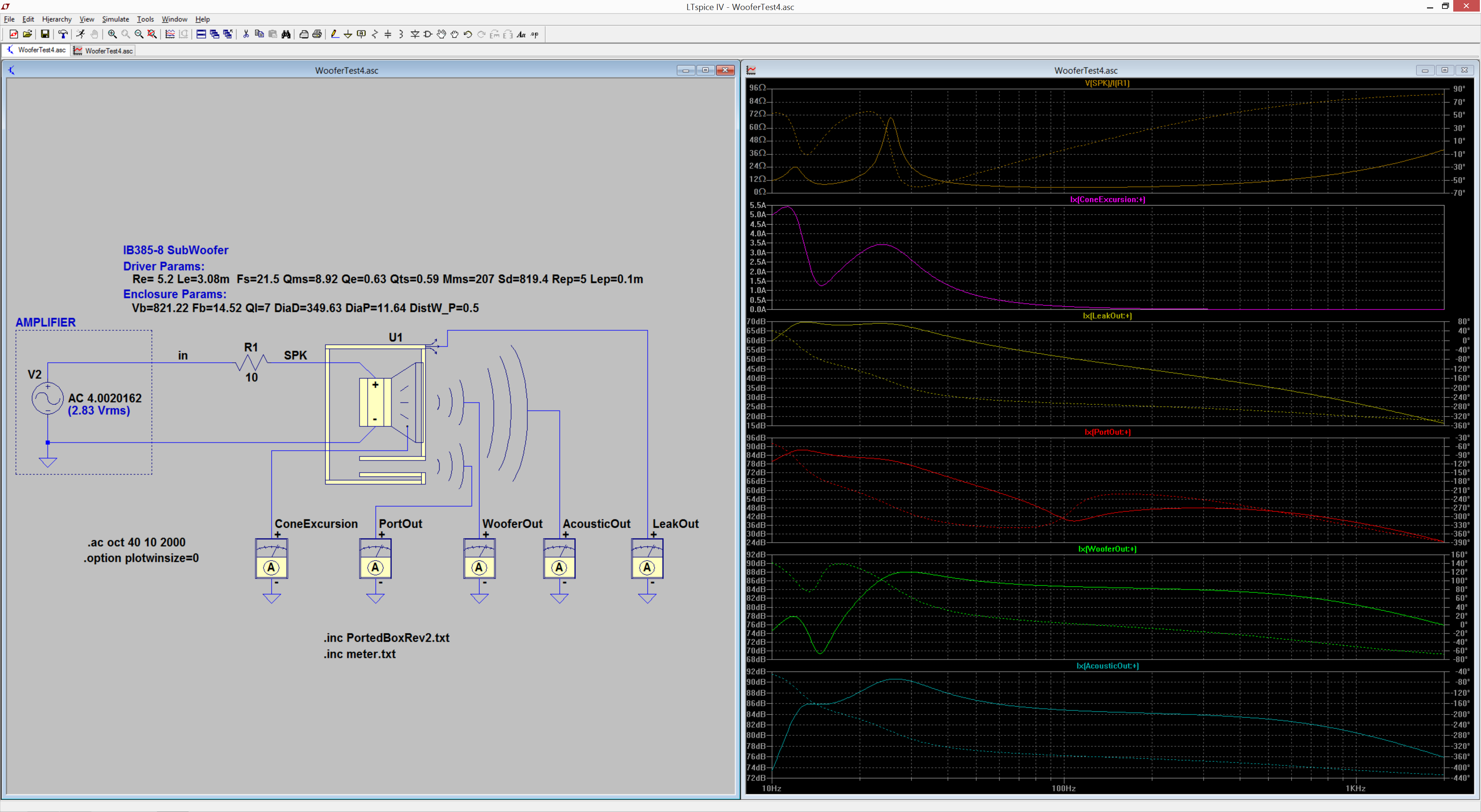

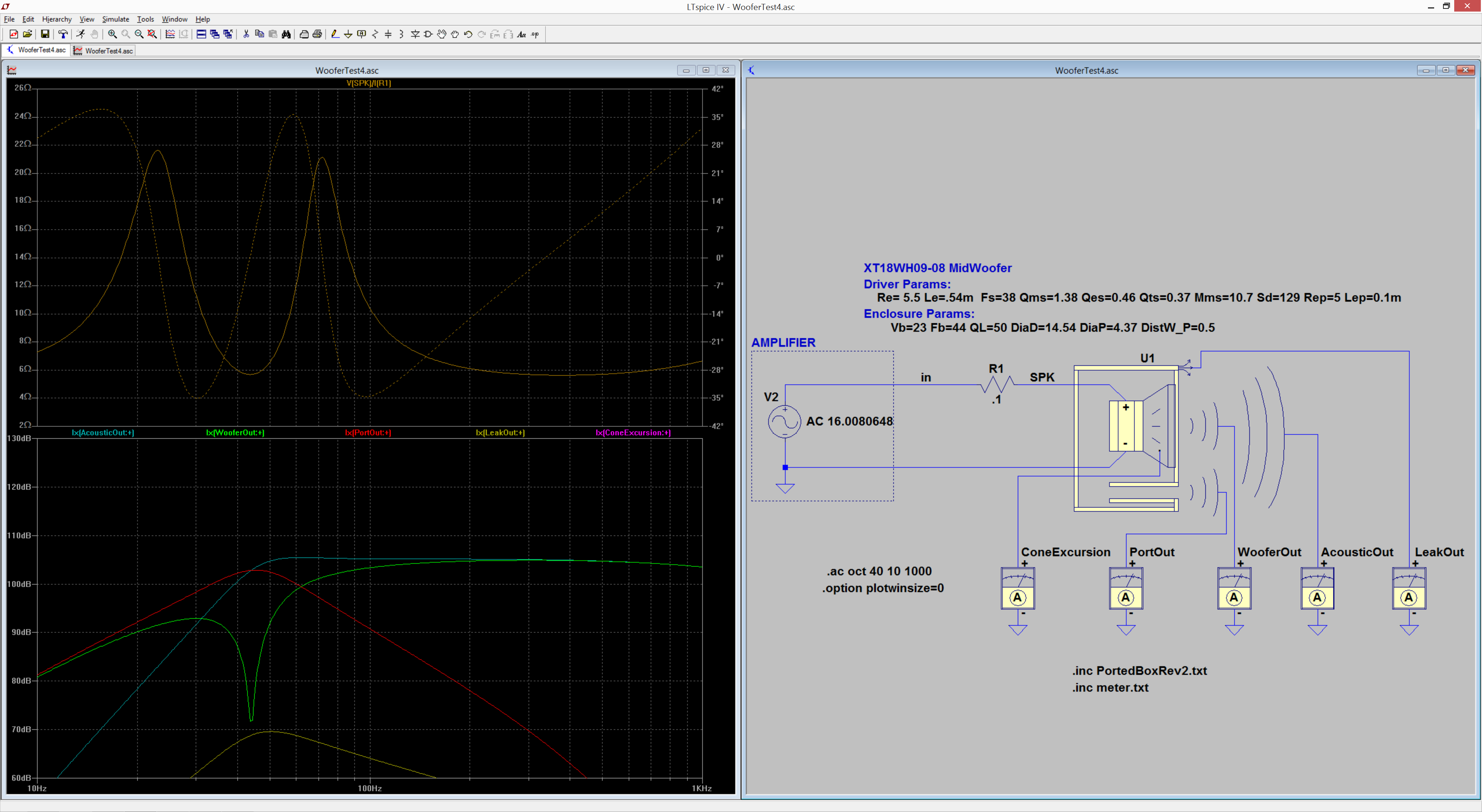

Hi
Here's a version with Acoustics modeled as well..
eT :)

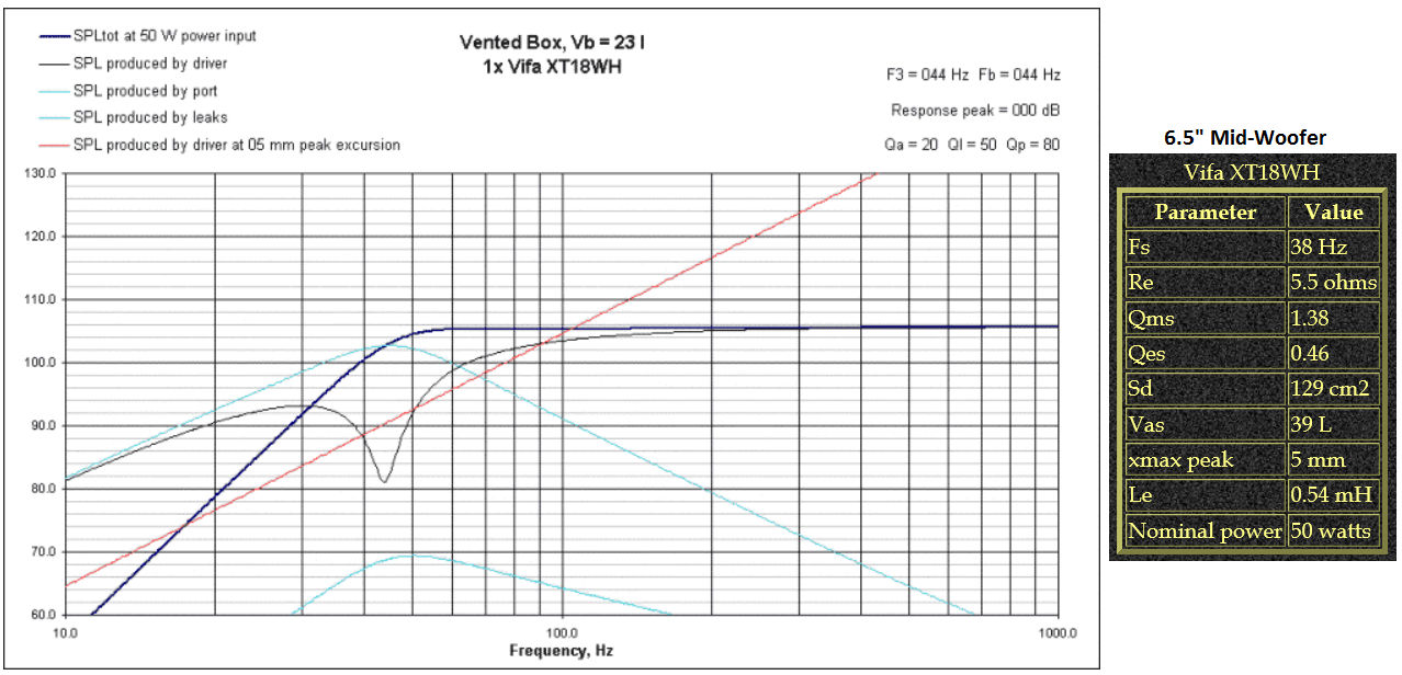

I think you have a BOOM box that has a +6dB peak at about 28Hz probably caused by the 10 ohm resistor in series with the speaker. The extremely low output impedance of a modern amplifier damps resonances like that so the speaker response should be completely flat.
Here is the response of a little woofer in a vented enclosure:
