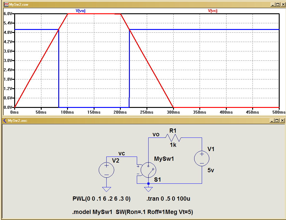

I am trying to model a simple linear circuit through LTSpice but I am having some issues. I am familiar with Spice, using it periodically throughout my college career. However, this particular problem I'm working on requires modeling of a switch inside a circuit that closes/opens after a given amount of time - just a simple time-delayed switch. This seemed so simple when I first saw it, but apparently LTSpice doesn't have any component that will actually do this.
I tried using the voltage controlled switch device but I ran into some really complicated stuff with threshold voltages and exponential functions that I wasn't familiar with at all, since I've never used that device before.
Does anyone have any advice? I can't imagine that a component this simple is super-complicated to model. Thanks.
Please post your LTS *.asc file.?:)

S1, the voltage controlled switch, is located in the circuit in the correct place. It's supposed to close after the circuit has been operating for 10s.

I'm after your .asc file , not the model of the switch.:)
That is the asc file for the entire circuit. I told you it was simple :)
Look at this, use the 'sw' from the LTS lib.
AAesp01..gifView attachment MySw2..asc
