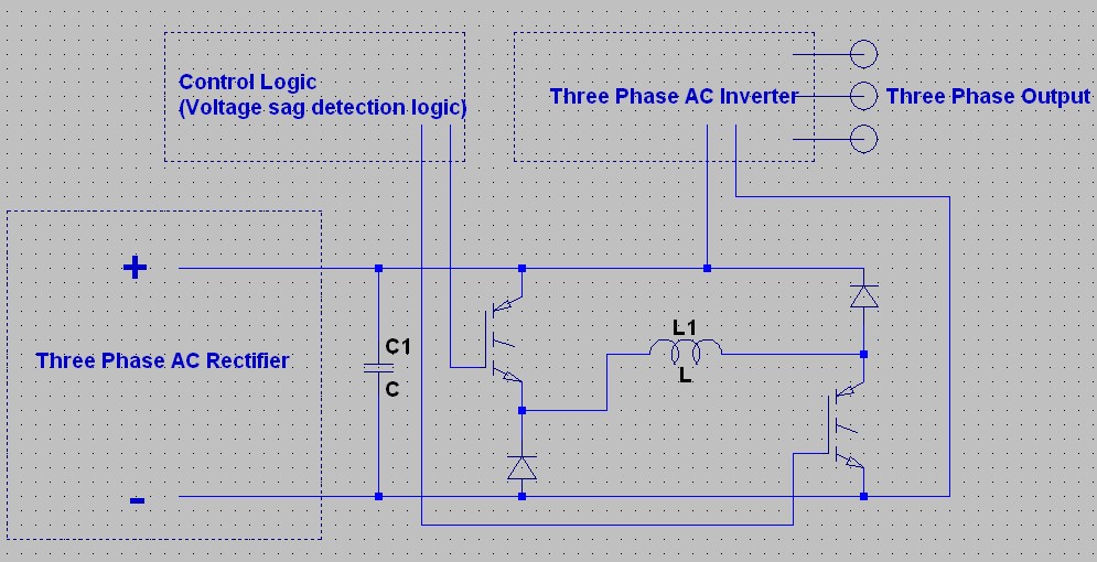

In a superconducting magnetic energy storage (SMES) project, I need some help that how to develop a system using LTSPICE if a voltage sag occur, the spice circuit balance this voltage drop by discharging energy stored in the SMES coil.

My question is that how to develop a system using LTSPICE if a voltage sag occur the spice circuit balance this voltage drop by discharging energy stored in the SMES coil.
Perhaps you could model the SMES as a capacitor and model the voltage stabilisation system using a standard linear voltage regulator model?
A sample circuit of smes is attached, I need how to make a system which detects the voltage sag which trigger the 2 quadrant converter to charge or discharge the coil.

Assuming 'the voltage' is DC then use a comparator and a reference voltage source to detect sag.

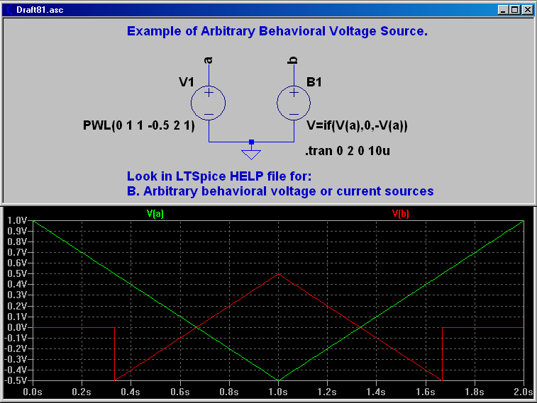

Study the example I have attached. You can use the BV to model very complex behavior...
