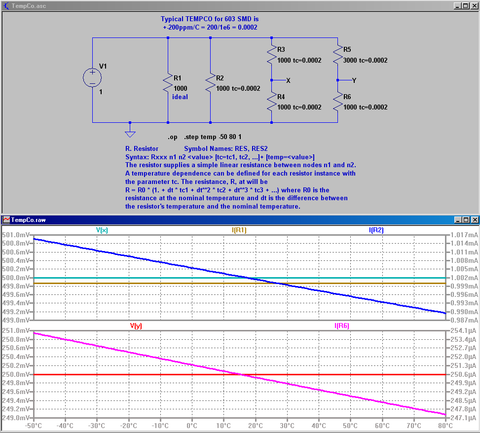

Ok, now need to set the temperature coefficient of a resistor in a simulation, but when I bring up the parameter list, the TC isn't listed. I was digging around to see how others are simulating resistors with resistance dependent on temperature, and found This page. It's a very clever idea to use a current controlled voltage source (CCVS) to model the resistor. But, isn't this a little over complicated for a simple TC drift simulation? Should I just create a new resistor symbol and pass the TC or define a default? Has anyone tried this? Thanks.
Here is something that may help you

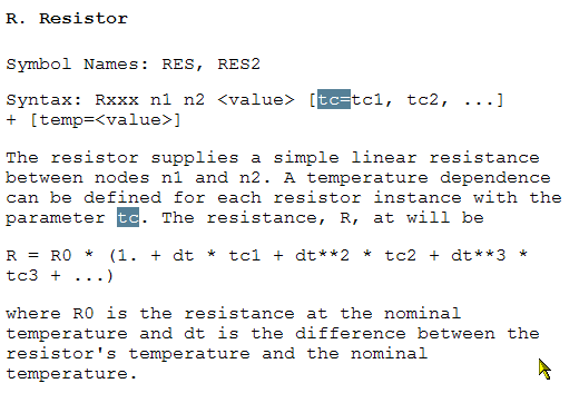

That's great, but I can't edit the netlist, and Help doesn't tell me how I can specify TC on the schematic. When I bring up a resistor's properties, I only get "value" "tolerance" and "Power Rating" TempCo isn't listed as a property I can edit.

hi D,
Have you tried 'select the resistor as though you want to change its value, on the same line as the value add, tc=xxxx'
