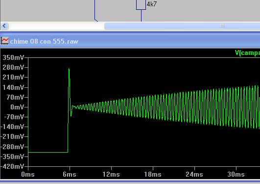

I intend to replicate the sound of a simple clock's chime. So far, using LTSpice, I managed to control attack and decay times.
Please check the sound in the attached .wav file. I understand that kind of a thump is perceived at the start, which I find annoying and far fom nice.
The signal, taken at the output after several DC blocking caps looks as shown. Really.
My questions:
1) Do you agree on the initial anomaly? My hearing is definitely bad so I do not trust much on what I perceive.
2) If so, is it an artifact created by LTSpice when sampling the signal and passed into the .wav file?
3) Or is it that initial jump of around 300 mV pk-pk, the reason of it?
4) Or just my sound card?
Comments appreciated.

The problem is due to the Attack, it Starts at 0V,[ which is full volume] then jumps to +V [ which is minimum volume] then decays towards zero to increase the Volume.
E

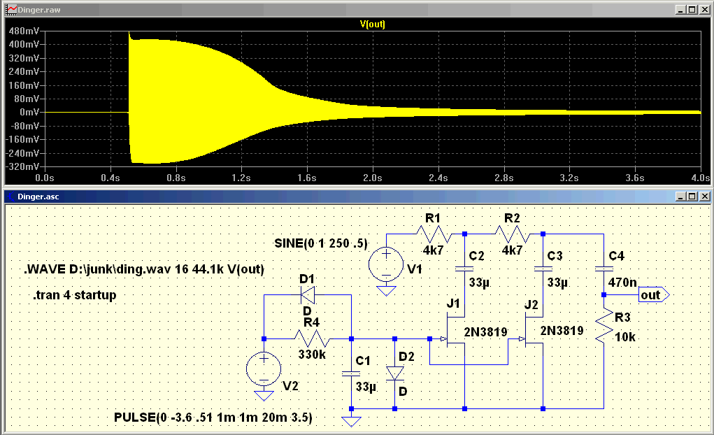

Hi Agustin. Try this :-
  • Dinger.asc
Hola Alec,
Thanks for the circuit. Not intuitive, at least for me but certainly simple.

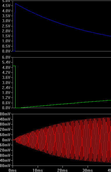

In my circuit, by adjusting the attack time the thump is gone. That part seems critical and I would like to see how easy it is in real HW.
Next is to adjust the frequency, maybe add one harmonic or two and simplify the resulting mess. Too many timings to care of, I guess.
