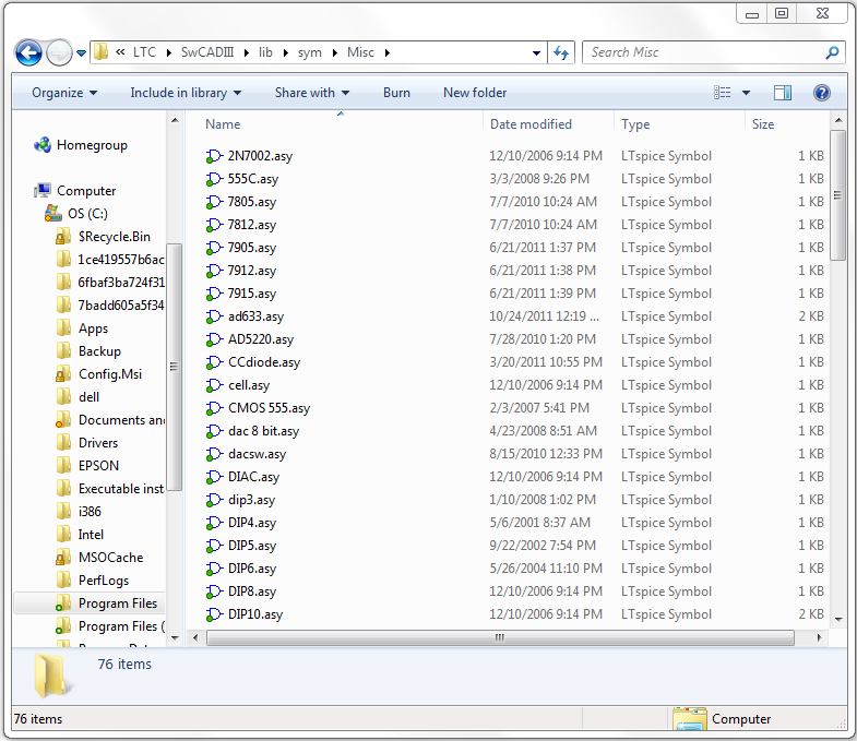

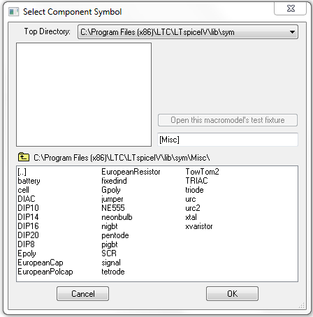

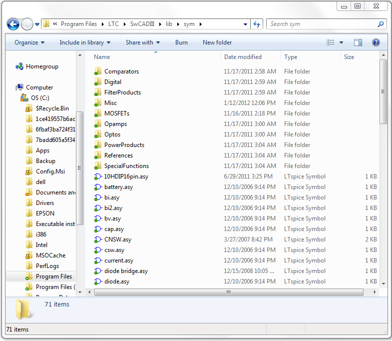

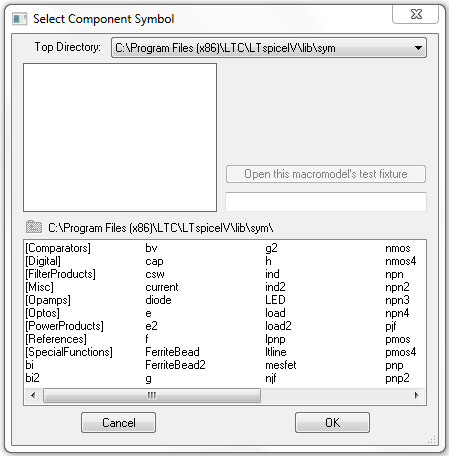

Attached are screen shots of the dialog boxes, and the folders after I deleted battery.asy from sym/misc.

Eric, it was working the same way for me until recently. I now have battery.asy only in the sym folder, but it shows up in LTspice only in the Misc select window. Not a major problem, just an annoyance.
I looked at your file, and it is exactly the same as mine.
Thanks, Ron
