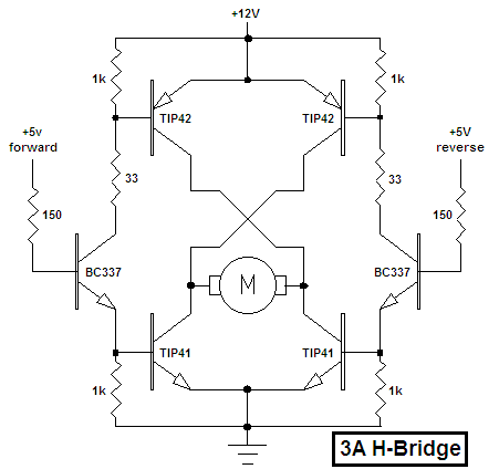

You need a transistor circuit that has +5V and 0V inputs and 12V outputs. An H-Bridge circuit will work like this:

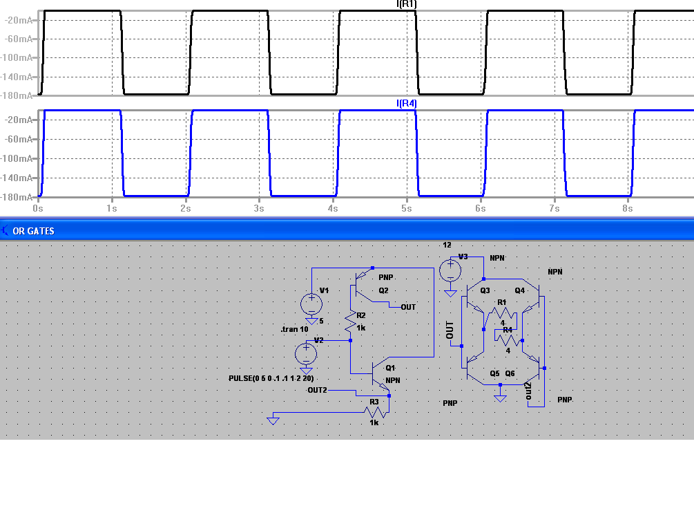

NOW I am confuissed, NEED advice
I thought I had this figured out (**broken link removed**) but implementing to make amplifier work?
here is what I have tried and thought I was getting an mirror signals for the amp but no.
any ideas as to how to do this?
https://www.electro-tech-online.com/attachments/555-pump-amp-png.42284/
End result, feed the piezo tweeter both the 2-8khz frequencies and the 15-20khz frequencies. Maybe have one output for the 2-8khz and another pin with the 15-20khz but still need to alternate the inputs to the amp?

Looks ok in LT SPICE but will it really work?
using two 4 ohm resistors to help indicate voltage output
Your switching amplifier will work if you remove Q1 and the two LEDs and replace them with an NPN transistor inverter for one input signal to the amplifier.
Mix two frequencies together then feed the mixed signal to one input of the amplifier and the transistor inverter.
Lost?

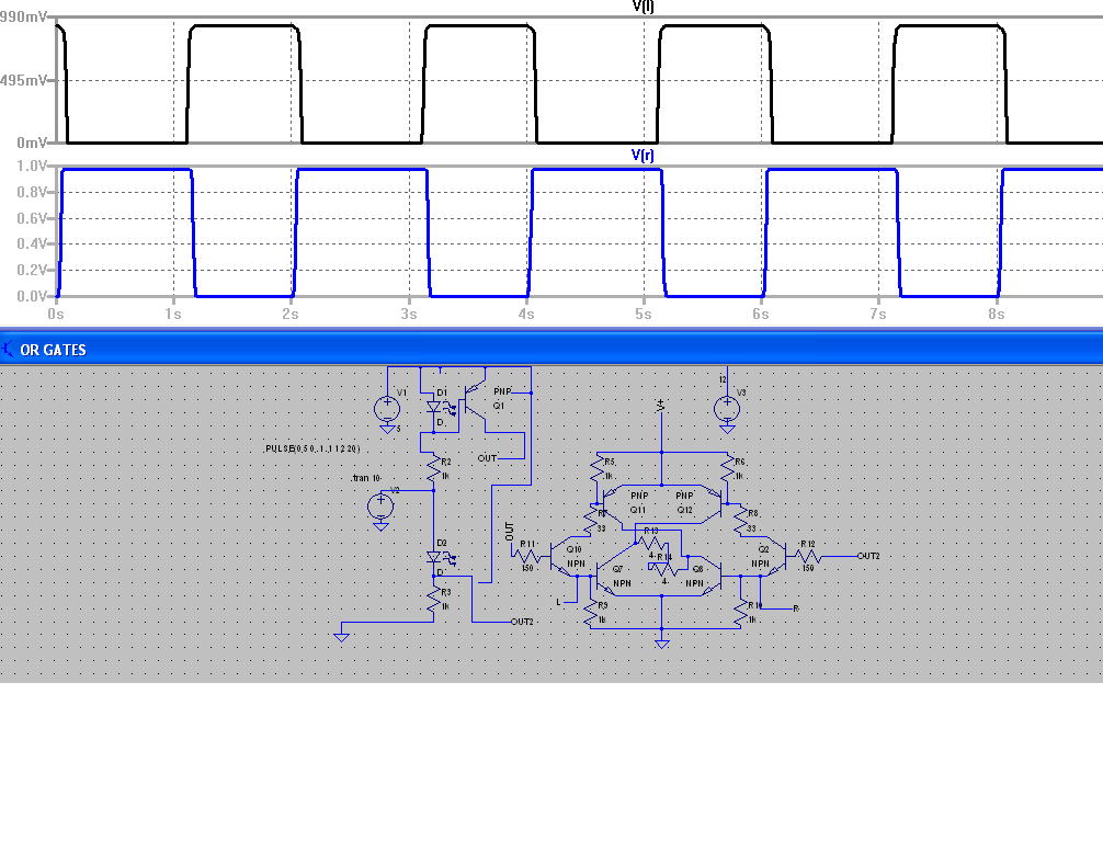

Have the 555 outputting a signal that pulses one of the LEDs faster than the other (need to get a 50% duty cycle) but your mentioning using the NPN as an inverter? and only one signal input?
Need more info.
ONE big reason I conjured the 555 circuit was its basically the circuit that alternates the LEDs.
I think I posted a link to schematic
DUH it dawned on me

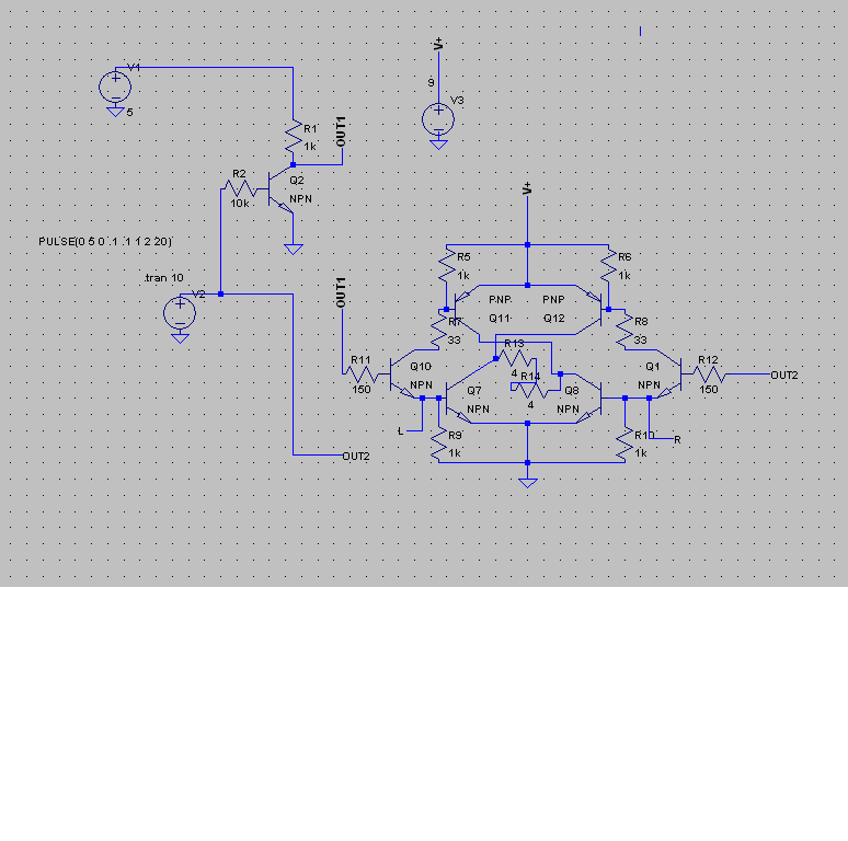

Here is what I THINK your talking about?
Now to mix the signals so I still get the alternating inputs?
The resistor values for your inverter transistor are too high.
Your generator signal is +5V and 0V but the output of an ordinary 555 (with a 5V supply) is only +3.5V and close to 0V. Then the amplifier input transistor connected to the 555 has an base current of (3.5V - 1.5V)/150 ohms= 13.3mA and the amplifier input transistor connected to your inverter transistor will have a base current of only (5V - 1.5V)/(150 ohms + 1k ohms)= 3mA which might not be enough current. The 1k collector resistor and 10k base resistor of the inverter should have their values reduced to 270 ohms at the collector and 2.7k ohms at the base and the 150 ohm series resistor to the base of the amplifier input transistor should be removed.

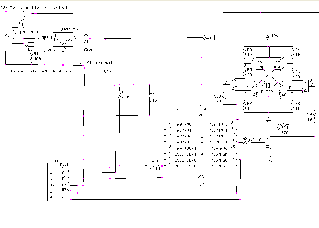

Here is my schematic that I hope works.
Not real sure about power supply as I have never worked with LDO power supply.
Hopefully this contraption works??
I wish I had a frequency meter.
Never worked with piezos either but it appears that the higher the frequency, the higher the voltage across the piezo?
R10 in your latest schematic should be replaced by a piece of wire.
The amplifier does not increase its output voltage due to magic nor due to a piezo load. The output voltage should be an alternating square-wave that is about 11V p-p but since its polarity alternates then it is like 22V p-p. It is the same as a sine-wave that produces only 7.6W into 8 ohms.
The datasheet of a piezo tweeter shows peaks and valleys at different frequencies caused by resonances. A peak is loud and a valley is not.
Well it's pretty dang loud. I included some aditional frequencies Now I get a random 2-8KHZ and 15-20KHZ.
I can tell when it hits a 7KHZ as my hearing aids start making noise, only briefly. Must be a resonant thing.
WHY replace the 150 with a wire.
The mirror input (first input)has a 350 ohm resistor. Should these be equal? Am thinking maybe yes?

WHY replace the 150 with a wire?
The 270 ohm resistor turns on the right side of the amplifier and the 350 ohm resistor should also be 270 ohms to turn on the left side of the amplifier.
The 150 ohm resistor reduces the current to the input of the amplifier which is not wanted.
