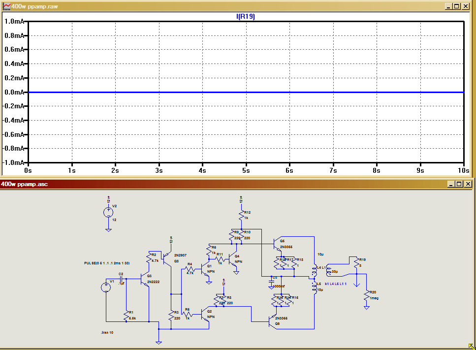

the transformer is each pri is 10 turns the sec is 30
keep getting node error.
it dosn't help when the help file is blank
why ???

hi D,
The secondary of the rightmost transformer is 'floating'.
Either add a normal ground symbol or the F4 'COM' and link back to 0V, via say a 1meg, as shown here.
  • 400w ppamp.asc

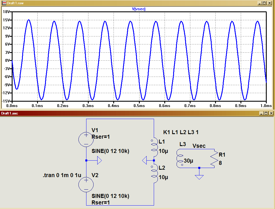

The SIM program doesn't work probably because your coils are separate chokes instead of coupled together into a transformer.
This is WRONG, the coils are drawn as a transformer and defined with mutual coupling of 1 in the LTspice directive.
EDIT:
Added a cut down image of DEB's LTS file/image.
He had mistakenly made the K1 L1 L2 L3 1 DIRECTIVE a COMMENT
