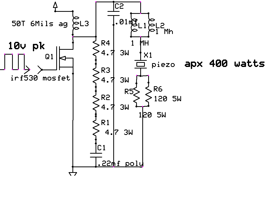

See The schematic that is posted w/ this thread but simulating?
I get 1400000000.00 TA
am doing something wrong??
The inductors are 1 MH
the L3 is 50 turns of wire on some core f it really matters in an LT spice simulation?
The xtal is supposed to be a piezo tweeter 130db.
curious as to output etc.
the input is 10v pk

LTSpice cannot help you unless you have frequency/pulse width/risetime spec for the input waveform, supply voltage, inductance and series resistance for L3, and a model for the piezo (this will be fairly complicated, consisting of inductance, two or more capacitors, and loss resistance).
