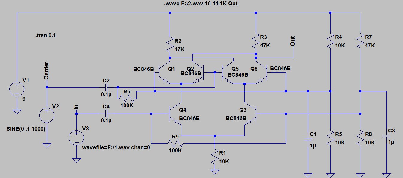

I have generated a circuit to pitch convert a signal. It seems to work fine with fixed frequency signals.
However I have a sample of audio that seems to import OK using the Spice labels. Displays fine.
wavefile=F:\1.wav
However I cannot replay the output whatever I do using .wave "f:\2.wav" 16 44100 1 1 Filterop directive. It shows the imported audio,but the wav file won't play and Soundforge thinks it's an incompatible file format.
Any ideas?

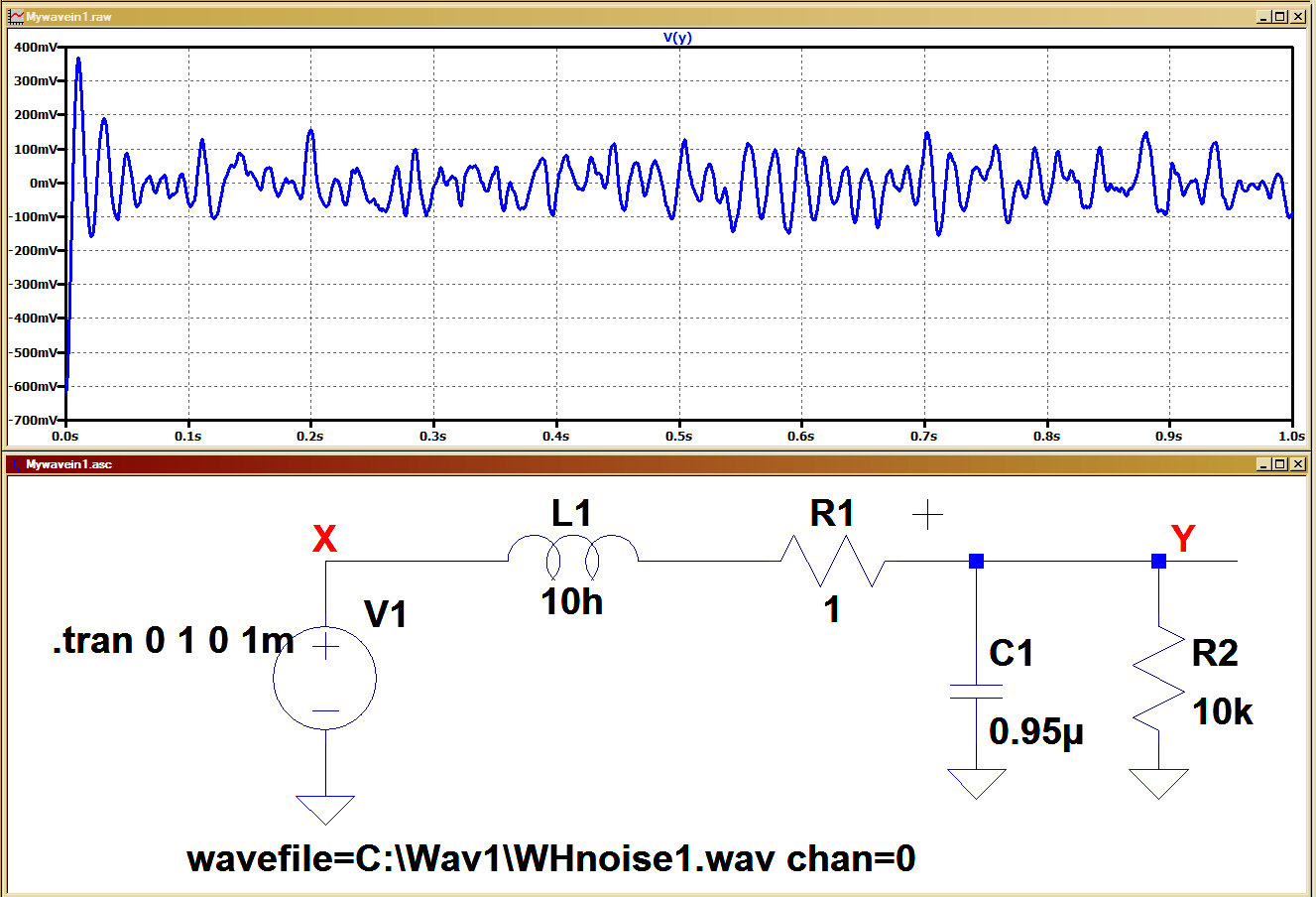

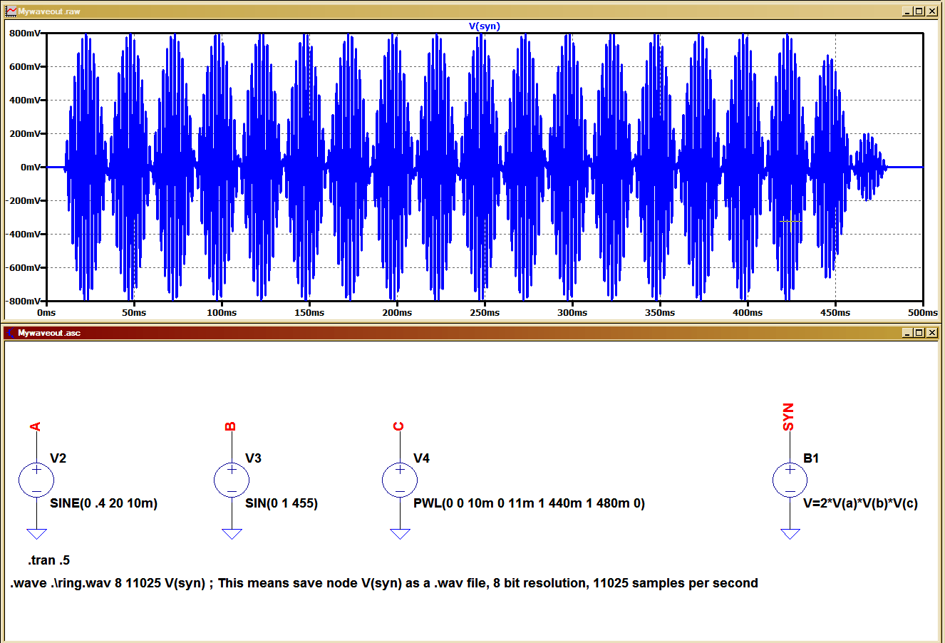

These are two LTS wave, in/out samples I use.
I have created using both Audacity [ freeware] and modules, they all seem to work OK.
The .wave directive is for saving a wav file. To play a wav: create a .PWL voltage source, use the Browse option to import the wav file as the PWL source, then right-click and edit the "PWL file=....." property to read "wavefile=.....".

What I am trying to create is a simple circuit that will pitch convert speech to a band around 1.5KHz upwards preferably variable. I could do it in a micro easy with messing around with sampling, but as an interest wanted to have a go to refresh my well out of date analogue designs.
I based it on antilog(log(x) + log(y)) = xy where one is an offset carrier and the other is speech. I added a HP filter on the end. I am sure it could be reduced considerably, but I never got that far in the sim. I did look at the Gilbert Cell but it didn't seem to do what I wanted for some reason.
I have looked at the MC1495 mixer, but these days I prefer to simulate a circuit before switching on a soldering iron. I couldn't find any 4 quadtrant mixers to play with made by Linear Tech to drop into LTSpice.

Shouldn't your directive read .wave F:\2.wav 16 44.1k V(out) ?
I think you should run the simulation as long as the audio signal ... otherwise, if the time you choose was silent ... that is what you'd get.

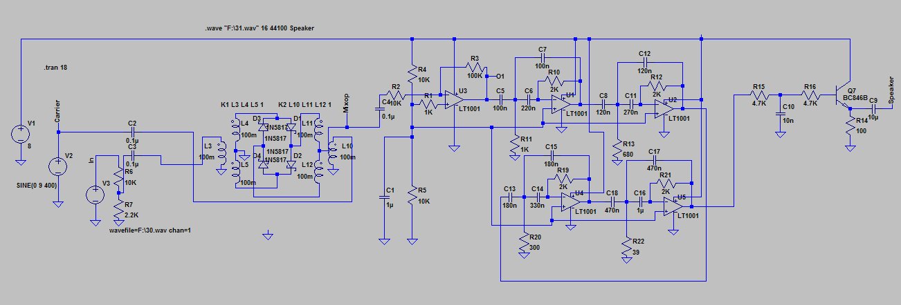

Well once I put the file path in inverted comma's it appears to work. However the output sounds awful. I have tried a ring modulator cct and that doesn't sound much better even with a multipole HP filter derived from TI's Filter Pro.
The input to the .wave command needs to be a waveform with an amplitude < 1V or you get clipping.
Here goes. How do I determine what is 1V in a 16bit wave file? What is the ADC referenced to?
Your sim outputs ~ 120mV peak amplitude at the 'Speaker' terminal in response to a normalised .wav file as the V3 source, so that's well within the 1V ceiling for recording with the .wave command.
Edit:
According to LTS Help "The .wav analog to digital converter has a full scale range of -1 to +1 Volt or Amp."
