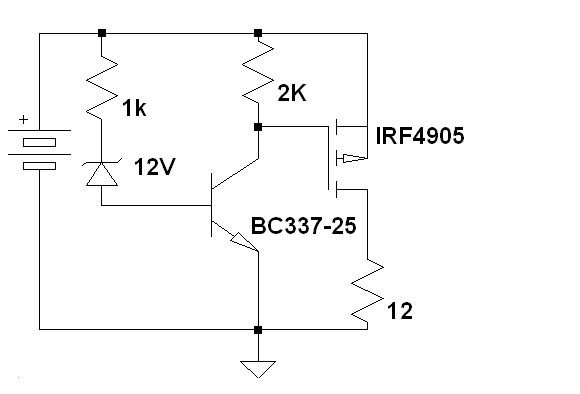

Looking for a low voltage cutoff circuit which will cut off the load when my car battery falls below 12v the load is a lamp (10 watt).
Suggestions ?

The TL431 Low Voltage Cutoff circuit I posted has hysteresis. If it chatters in your setup, changing one resistor will stop that.
Isn't your load grounded? If so, you need a high-side switch, and a PChan FET is better for that than a NChan FET

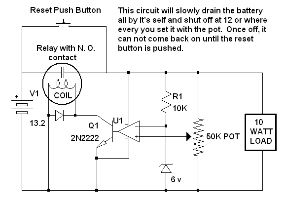

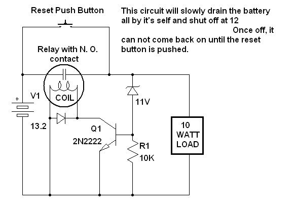

Here's a method for you, the relay could be as powerful as a starter relay, but that's excessive for a 10 watt load, but if it's on a camper or vehicle that get's used often, it will keep you from killing the battery by leaving you lights on.
I haven't tried the second drawing yet, going to put it together and test it, and if it works, put on mine, I hate having to reset the radio when I leave the lights on or the dome light on over night.
Kinarfi
Except that neither circuit will work as posted
btw: A relay is usually more expensive than a FET, and the relay coil wastes power...

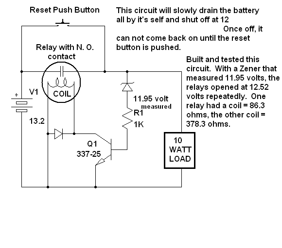

Mikes right, the 2nd one would fry the zener or transistor, but on this circuit, it worked repeatedly, dropping the relays at 12.52 volts, the zener measured 11.95 volts. I have a 50,000 µf, 40 volt capacitor and I would charge it, trip the relay on and measure the voltage when the relay opened, 12.52 volts, tried it with 2 different relays, and got the same opening voltage. One relay was 86.3 Ω and the other was 378.3 Ω. I used this exact circuit, except I didn't put the protective diode across the relay and shorted across the N. O. contact with a piece of wire.
Kinarfi
The second one wont fry, but it won't work, either.

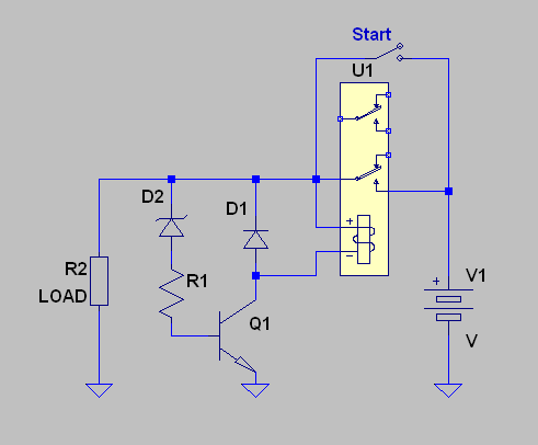

Try this:
If your not worried about the voltage coming back on as the voltage of the battery regenerates, You could use a FET like on this drawing. The IRF4905 is a 72 amp PFET.

Mike, where do I find that relay for spice. I think the 2nd would fry something, spice shows 97ma through the zener and at 14.4 volt, automotive, you would have around 2.4 volts Vbe.

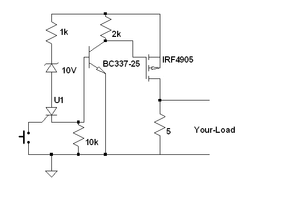

This also appears to work according to spice.
all solid state, almost. I keep playing with this so I can put it on my camper and truck.
kinarfi
Here's what I'm putting on my Camper and Truck. I may not need both IRF4905s, but I have them. The reset button can be the Ignition switch or a separate button or both. The two zeners should add up to the cut off voltage you want or a little less and then the cut off voltage can be tweaked with the addition of resistors or a pot.

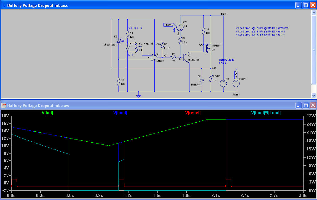

Still messing around, I think I like this one the best, battery drain is about 3.25ma and 0 when off. Simpler than the hysteresis method and more adjustable for drop out voltage.
Kinarfi
  • Battery Voltage Dropout mb.asc
