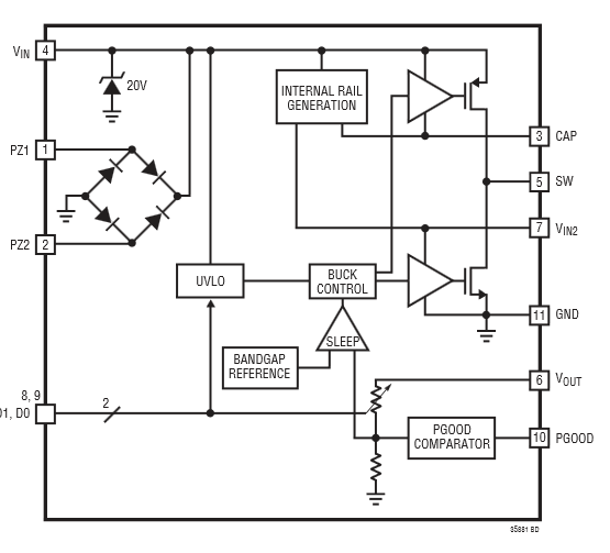

to the point, I'm looking to build a circuit that can capture low ac voltage (.1v-5v ac) from an induction generator and turn it into dc volatage (10v dc).
efficiency is veryyyyyy important.
I have very little electronics experience, although more than the average but I think something using mosfets would work or maybe a full wave rectifier diode...
any help is greatly appreciated.
-Nick

Ronsimpson's references are good for turning low voltage DC into higher voltage DC. But before that there is the problem of efficiently converting the AC to DC. The obvious solution for that is to use an efficient transformer to raise the voltage to the point where Schottky diodes or MOSFETs used as rectifiers can be efficiently used.
What is the lowest frequency of the AC from the generator and what is its current?
You do realize that converting .01A @ 20mV to 10V means the current is reduced to 20 microamp even with 100% efficiency.

The LTC3109 in post #3 clams it will work to 30mV and auto sense polarity which might be like "AC". I have seen it work at 50mV.

This will probably not work for you but there might be an good idea in it.
I have a high voltage low current source. This does work. The diodes loose 0.4 volts.
In your case it will convert the AC to DC. Then store anything above 0.4 volts on a capacitor.
The DC to DC converter will make a regulated supply for running a micro computer or small radio.
If there is more energy than needed the power is stored for later use.
