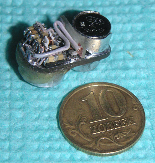

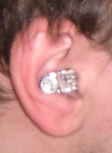

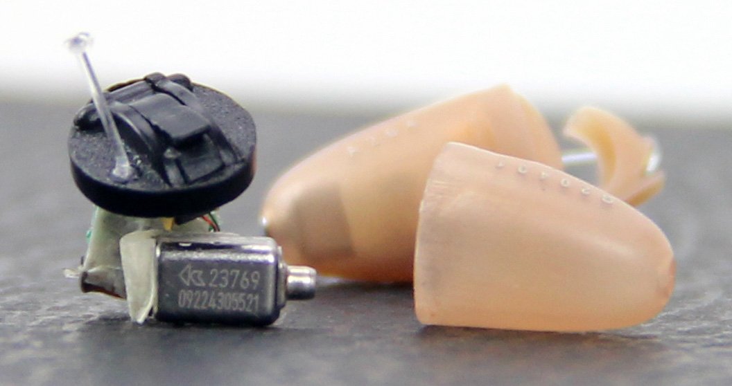

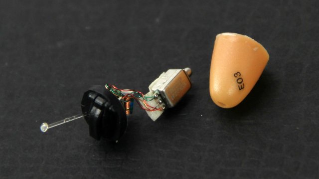

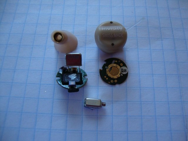

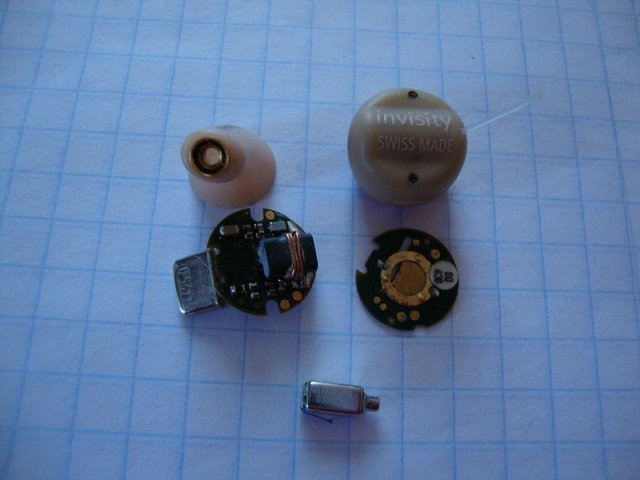

Dear Community,
I need your help - for a extended school project (Topic: Effective transmission of sound) I'll have to build up a fully-functional wireless audio receiver.
How I realize it (digital/analog) is doesn't matter - but the "big thing" is, that it needs to be as small as possible because the hole project should be realized as a pair of wireless in-ear buds.
Because of the limited battery size (~1/4AAA or button cell) and therefore the limited capacitance, the circuit should work - if possible - with:
  • Supply Voltage = 1.2V
  • Current ~ 0 - 10mA (if somehow possible)
  • And of course: as small realizable as possible!
  • If you have a low-power digital idea - tell me, I would prefer clear sound combined with µ-power consumption!;)
At the moment I'm not really sure, if it's better to do the transmission digitally or analog - as far as I know, it's maybe more current-saving doing it all analog (µ-Power FM receiver?)?
But because I'm not sure - I'm asking YOU!
I'll appreciate every advice and suggestion of yours. Of course - circuits (or snipets of) are more than welcome :)
Thank You in advance.
Greetings,
FabXy1
In attachment (some examples how the hole thing could might look like):
https://www.ansem.com/appstories/9999/8/ultra-low-power-fm-receiver-for-hearing-aid
microearpiece_2.jpg microearpiece.jpg Invisity1.jpg Invisity2.jpg phonitodigital.jpg post-46-1131983272.jpg post-46-1131983193.jpg
A hearing aid has parts that are too small for a person to assemble and solder together. A robot does it. The same for the tiny FM radio you want to make.
Where on earth will you find the circuit for an FM radio that works from only 1.2V? Where will you find the tiny parts to make a tiny FM radio? If the parts are available somewhere then they certainly will not sell less than thousands of them.
Instead make something that is possible and is practical.
