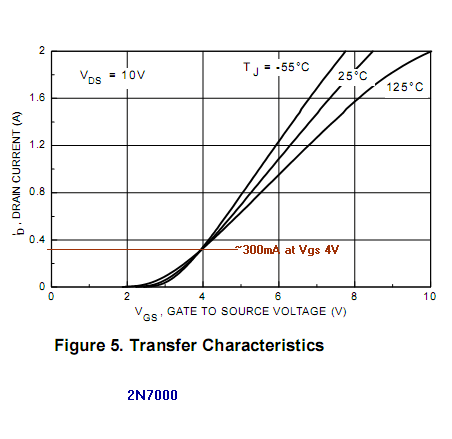

I need to replace standard NPN transistors (with additional base resisters) with a single MOSFET to work with 2.4V-4.8V (batteries).
I'm planing to place 2N7000.Data sheet says its designed for low power applications but looks likes it needs 2.1V Ggs.
Anybody have worked with this MOSFET with low voltage range like 2.4V-4.8V??

I need to light up my 5X7 LED small matrix system.
In that matrix one LED takes 22mA current.I need to drive one column of LEDs (7 LEDs) with this 2N7000.So for 5 columns I need 5 MOSFETS.

That should be OK.
Hi Eric thats a nice graph thanks.
The thing is my project is battery operated.From the graph below 3.5V is not going to provide sufficient current.

Whats the driving source for the 2N7000 gates are you using a PIC or some other ic.?

Its a mini 5X7 LED matrix project.I'm using a PIC.
Most important thing is this must power from batteries.
This is a hand held project so it must use batteries.To make the design compact I planned to use MOSFETS instead of BJTs.So I can eliminate base resisters as well.

I always use minimum and maximum spec's instead of a "typical" graph.
The graph for a "typical" 2N7000 Mosfet shows lots of output current when its input voltage is low. But the specs have a maximum theshold voltage of 3.0V when the current is only 1mA. It is spec'd to conduct well when its gate is 4.5V and 10V.
You don't know if you get a good one or or not so good one when buying a 2N7000 Mosfet.

Looks likes for the lower power work that 2N7000 is not enough.I'll try how it will operate with comparing with BJTs.
