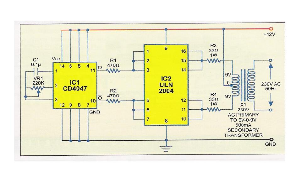

I am trying to find a low power inverter design that provides 230V 50Hz from 12V dc. I came across the following circuit, but can't figure out the transformer connections. The 12V positive line is connected to the centre tap of the transformer-what does this connection mean ??
Please see the attachment (ckt diag)- --
Awaiting your views.
Thanks.
Hello,
as you see on the circuit the 4047 IC creates an oscillation outputs which makes the "push-pull" on the 12Vdc using the ULN2004, then there is the oscillation signal on the 9-0-9v side of the transformer to make the inductivity and to get the 230Vac on the other side.

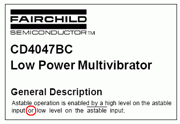

Hi Electrix,
If you built the circuit and it does not work, try connecting the Pin 4 of CD4047 to 0V(GND) instead.

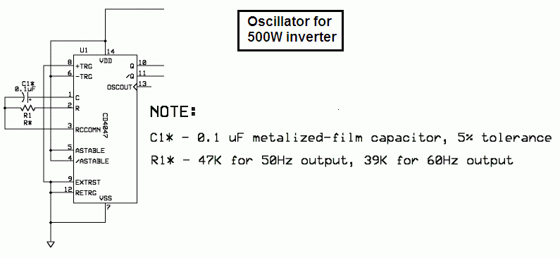

The oscillator won't run if pin 4 is grounded. It is the same oscillator circuit from this 500W inverter that works fine:
The oscillator will definitely runs if pin4 is grounded. Both pins are telling the chip to be an astable.
In fact I would connect up the pins this way because I think its is the correct way. I am not sure if the chip works with one pin telling it to be an astable and the other pin telling it not.
That's why in my previous post I stated "If it doesn't work..."
Hi L. Chung,
As long as one of the astable pins is correct, the oscillator will run:

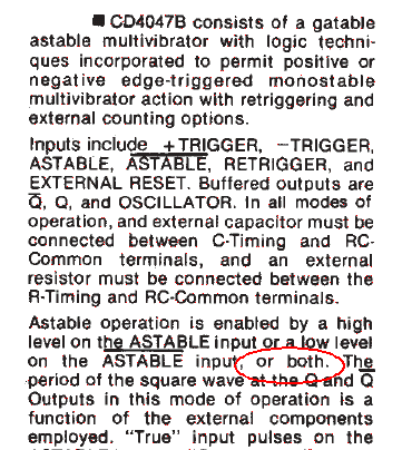

Nice one. I was not sure that it will run so I left myself some steps to fall back to but why are you so sure that it would not run if Pin4 is grounded?
It turns out that both of us are not wrong.

Hi L. Chung,
I had a quick look at the cruddy photocopy TI took from Harris Semi like you posted and didn't bother reading it. The other oscillator works with pin 4 high so I wrongly assumed it wouldn't work if it is low. :oops:
Thanks for pointing it out. :lol:
:D
We are victims of the datasheet.
Normally in these cases the manufacturer would put in a logic table in the datasheet listing all possible combinations of these two lines and the resultant modes. Sure would save us a lot of troubles figuring them out.
