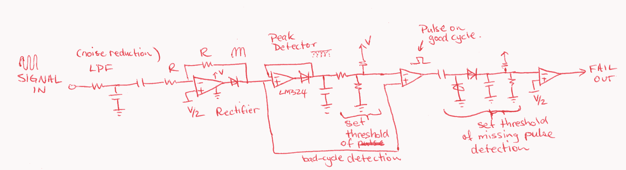

Your threshold detect should work. Perhaps your circuit is too slow. What is the rate of the pulses? If you have something like -----_---- you should be able to detect this condition with analog. Your circuit is flawed.
Exactly the situation but the circuit does not work and so we come full circle. What is wrong with my circuit, I know it shows the hated LM358 but I will use a better IC for the final build. I think I have looked at the circuit so long I just cant see past what I want to see.

It seems you need to use fast parts. LM358 is slow I think, there are many good analog designers ( I am not one) that frequent here like Ericgibbs, Rolf, and AG and many more. I am sure if you are patient, they might chime in.
The electronics world survived for a long time and produced many fine products long before the MCU came along. Fact is the MCU would be a solution, but if your not comfortable with this solution, you can do it in other ways...:)
OK i will look at the OPA series of faster amps and comparators. Also I will wait to see if Ericgibbs, Rolf or AG join the fray as you say.
Meanwhile I have changed the circuit to try and ground referance the rectifier output so removing (I Hope) the Vcc/2 component and also changed the pulse generator comparator pull up to see if that helps to improve input to the charge pump.

The vibration you both mention is correct and mainly used in larger pump installations but for my application it cannot be used. The pumps are small and mounted on large noisy machinery that would mask any signal - certainly the small changes that need to be detected to signal any impending failure.
Don't you already have the signal available? Isn't the sine-wave with the missing/attenuated cycles a signal?
What I'm saying is that the signal that you're already trying to use could be checked for frequency components outside the fundamental; so I think tcmtech's idea seems fine. I know you said you already do this for your other pumps; I'm guessing you just feed the signal through a notch filter (set to the expected signal frequency), get the average of the rectified output signal and compare this to a threshold. If the signal is not sinusoidal (i.e. has other frequency components) then the notched signal power/amplitude will increase. You may also wish to use an AGC on the input signal to give you a stable signal level.

I wasn't alluding to using X number of band pass filters; just a single notch (band stop) filter. The notch removes the fundamental frequency that would be present when the device is rotating correctly, and the output level would be of low amplitude. When something goes wrong (blade breaks), the notch would not remove all the other frequency components created (and the 'fundamental' would likely be outside the notch bandwidth), therefore the filter output amplitude would be higher.
In case you wish to stay in the time domain, I drew up the attached schematic. It basically generates a reference level from the peak of the signal, and compares the input signal to some fraction of that. The output of the first comparator a pulse for every half cycle that is OK; a bad half-cycle will issue to pulse.
I tacked a charge-pump on the output of this which will give a level somewhat proportional to the frequency of the incoming pulses - if the level droops then the output is signalled as faulty.
I didn't calculate any component values for you, but I can say that the RC time constant of the peak detector output should be long (say, maybe a few seconds), the first threshold should be at halfway between the peak level of a good and bad pulse. The charge pump threshold you can get through trial & error.
I used something similar for decoding IRIG-B (see the drawings on pages 21, 30 of **broken link removed**), and it worked very well at detecting high/low amplitude pulses.
I totally understand the concept of the notch filter and thats what started me thinking and the idea is great so I was just expanding it to a band pass filter - its exactly the same idea but allows a second bandpass filter to detect 2 broken blades. Its an idea thats so easy to try I may bash one up at the w/e.
Thanks for time domain circuit sketch, I shall go through this see if I follow the various stages, I get them all up till the threshold of the missing pulse part but I will study it.
Many thanks for this and I like the peak detector part - it makes the pulses out easier to calibrate.
So between this and the filter method I will be busy.
I will let you know which one is best when I get it to work.
Sure, if you need to detect the number of blades broken then the extra filters will probably be of use. If you just want to know whether one or more blades are broken, then just the notch will suffice.
And that schematic I posted, the output of the charge pump will decrease based on the number of blades broken, so you could also potentially use that with an array of comparators to tell you how many blades are wrecked.
