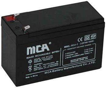

Just one of those lamps would give you about 15 minutes life from that battery.
A practical current drain from the battery you linked is about 50mA. Your lamps draw more than ten times that each....
12V 7Ah SLA
If you want it reasonably portable, get a 12V 7Ah SLA alarm battery.
And use a fuse ( 1 or 2 Amp ) in series with one of the battery terminals, shorting it out by accident will yield 70 Amps which will melt your wires.
Bear in mind with all these parrallel lamps the total current drawn.
If your total current is 1 Amp, then a fully charged battery should last 7 hours in theory, more likely after 5 hours a noticeable dimming of light is visible.
You could look at LED lights as alternative, less current and more coloour options.
