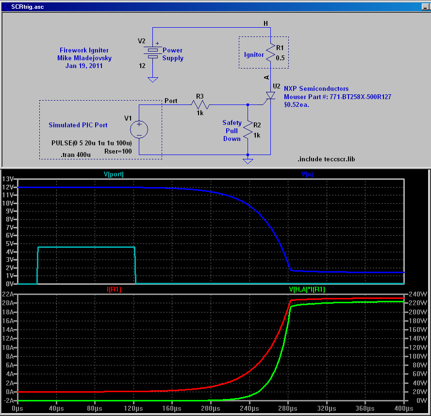

Here is another way to fire the fusee. I'm using a "logic gate SCR". Advantage over a FET: cost, short duration trigger, trigger directly from PIC or decoder chip. This SCR is rated to deliver an 80A pulse lasting 10ms. I'm guessing that at >20A, 220W the fusee will not take very long to blow.
In the simulation, light blue is the trigger pulse from the logic. Dark blue is the voltage at the anode of the SCR. Red is the current thru the fusee, and green is the power dissipation in the fusee.

If you want them to blow fast then double the current by using a 2Ω resistor.
It uses 30 gauge Nichrome wire, about an inch long. So I resist it down to just enough power to fire the fuse?
You need to shorten your bridge wire to 1/4" or so, and you will have to have a current limiting resistor on the output. The igniters offen short out after firring.
Some day you will what to look at buying E-Matches, thay realy are not all that expensive. Anyway you should stay as close to the real matches as posible so you dont have to toss your system, after you stop making the igniters. Andy

Yes I will need to be about 2Ω.

I'm thinking of going back to the 36 gauge. Its faster and requires much less current to blow.
