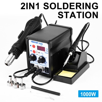

looking to purchase a hot air work station
I have one of these, which works fine; I've done quite a bit of SMD IC work with it.
I've never used the attached iron, I use my preferred Antex.

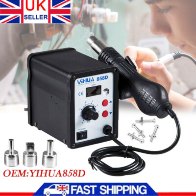

These appear to be the same hot air unit, without the iron & around half the cost:
I have one of the 858D series hot air tools.
It works OK.
I use it mostly for shrinking heatshrink sleeving.
I have used it a few times for removing multi-legged SMD components with reasonable success.
I initially bought it for attaching SMD devices to the PCB using solder paste.
But for most things that I do, I find it easier to use 0.5mm solder wire, chipquik flux and a good old Weller TCP iron.
