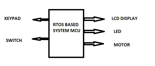

    Hello
    I need advice for RTOS project. suppose I have microcontroller connected to Switch , keypad ,LCD,LED and Motor. so hardware part is ready. Now I have to develop embedded software program. I don't know what my hardware can do with RTOS program. Can someone give me assignment or task on what type of task my device can do with rtos program.

    I am not really going to implement. but I will use ARM Cortex-M microcontrollers. actually I am looking the smallest example of RTOS program that do only few things than I can add another features. I just want to someone give me some advice for small program. later we will add some features step by step. what do you think , what will the simple rtos program. actually It has been long time I am searching but not getting right direction. all I have seen is very complex program

    There's no need for an RTOS for such a simple system, it would be a lot smaller, faster, more efficient and easier to write without one.

    I'm not.... I wouldn't use one.... I can achieve what I need from normal procedural programming..
    RTOS in my view, is really for complex programming where accurate timing is needed... Tasks done in turn.. As I said, I can achieve that anyway!!

    I agree, there seems little need for RTOS in microcontrollers, which after all only does what WE do ourselves, but at much greater waste of resources.
    I suspect the OP somehow imagines that using an RTOS will make it simpler for him?, while the opposite is actually true.

    An RTOS..
    Creates an operating system...
    Usually a timer set to fire every 10mS or so.
    You need several software stacks... Each stack mimic's a mini system.. We need to save all local variables and running registers...
    The first task: - load the relevant task 1 program counter, working register, flag register and all local variables
    execute x many commands.​
    The Second task: - load the relevant task 2 program counter, working register, flag register and all local variables
    and so on..
    One task is usually a watchdog ensuring that other tasks are behaving..
    You really need a bit of data memory when using an RTOS... The smallest RTOS is around 6K of code space, so small and mid sized pics are out!!
