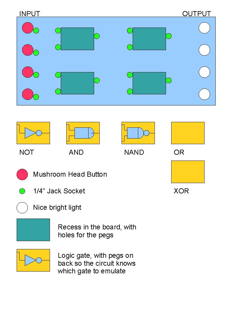

on the same line you could build a big (cos kids like big, and they look more fun) logic simulator. the one with a basic grid. with big mushroom head buttons on the left(inputs) and nice big lights on the right(outputs) where you can put any one of the logic gates in the middle, and it shows its fuction, kids can come up and press the buttons ect, learn the truth tables.
for the logic bit - i would build a circuit and mount it behind the display with all the logic built in, and use a series of PEGS mounted in differing patterns on the back of the large 'logic gate', where the peg would hold it on the board but at the same time, the pattern would tell the logic board what it was to simulate ( i guess you could rfid, or any hundreds of other methods to identify the current 'logic gate') i would also use rope lights as the connection between the switches, and the logic, and the output, that way the kids can see which wires are HIGH (lit) or low (Not lit).
i know this is a terrible description, but if you understand any of it, and are interested in this idea then let me know and i'll draw you some pictures to make it clearer.
this is a VERY basic drawing of what i mean. you would use rope light, with 1/4" stereo jack plugs on the ends. (2 conductors for the ropelight, 1 for the signal) to connect between the gates.
this lets you do simple 1 gate circuits to explain how each gate works, and also up to 4 gates to build basic circuits to show how they work together.
I imagine it in brightly painted MDF, and i like the idea enough that im gonna build one myself and see if its any use to my kids school. As i know for certain that at the school i attended thay never placed enough enphasis on technology, and it is the way of the future.
EDIT: just noticed that i forgot to put the 1/4" jack sockets on the drawing next to the output lights
